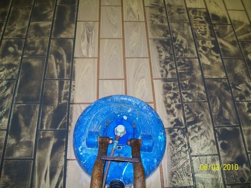

Jul 29, 2010 #1 C Curtis Pennington Member Joined Jul 12, 2008 Messages 1,537 Yes thats my older tile tool.......anyway 12 years this tile never been cleaned(restaurant)....oxy,prescrub (turn to mud) rinse looks brand new.
Jul 29, 2010 #2 daniel@procarpet Member Joined Sep 7, 2008 Messages 3,797 Is that oxyblaster you are referring to? Nice job.
Jul 29, 2010 #3 dgardner Moderator Joined Apr 7, 2008 Messages 5,109 Location Phoenix, AZ Name Dan Gardner What a difference! What machine do you use to prescrub?
Jul 29, 2010 #4 C Curtis Pennington Member Joined Jul 12, 2008 Messages 1,537 ....oxy... dwell 15 min .... prescrub with 175 /brush....rinse 800 psi .....BANG.
Jul 29, 2010 #5 Scott S. Supportive Member Joined Feb 3, 2008 Messages 3,225 Location PA Name Scott awesome. i can hardly get tile jobs out here where i am. no one even cares about having clean tile out here.. thathurts
