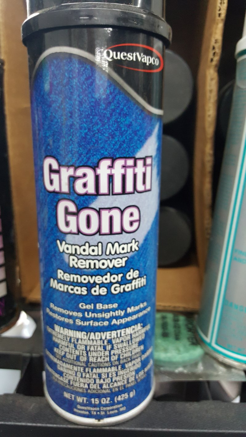

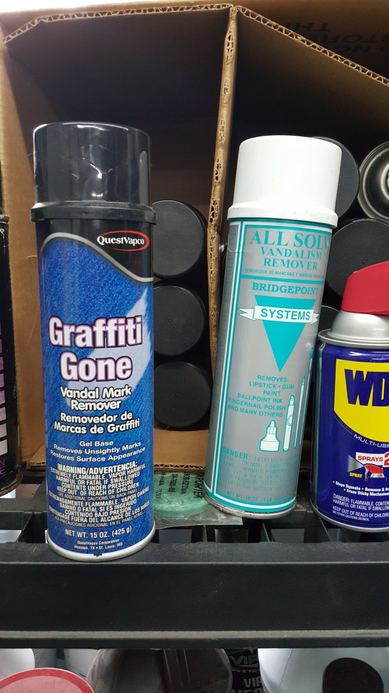

Just did a church again last week.
This made faster work of the wax drops
And we like on paint removal
Quest Graffiti Gone
Have to find on Amazon but make sure when buying look for case of 12. One place comes in cheaper but only 6 in their case.
Have tried others and this still works best for us...

You guys use a stair tool on the pews? What kind? Glide necessary?
Great product.
Yes...we use stair tool with hybrid, but could be any glide I guess....
We hit all the large areas with stair tool...and TM set at 300 psi with our modified dual jet swivel head PMF wand....
Then we will trim out the edges with a hand tool as needed....
