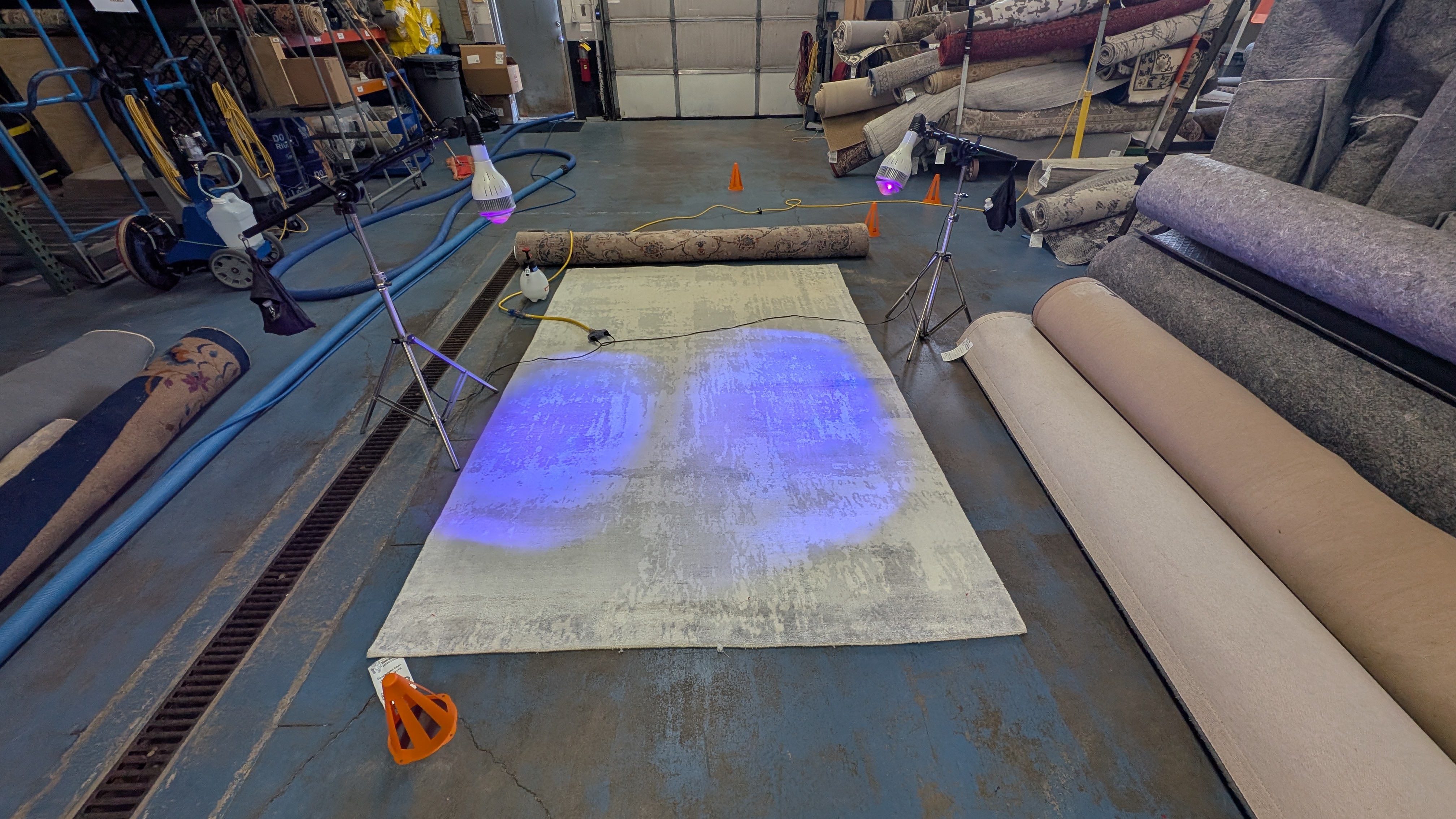

UV light helps if it's stubborn.. I haven't had a problem with multiple applications.....but it requires various trips..

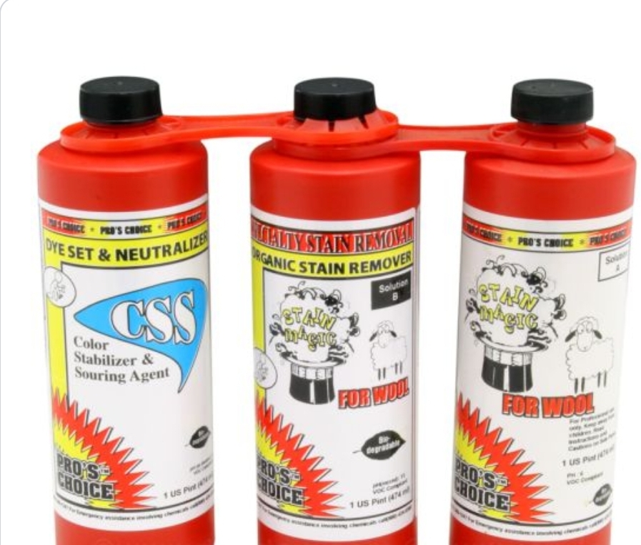

What are your usual safe products? Can you find out more about the coffee? What kind was it? Decaf or not? Cream or sugar?
Depending on the questions above I've had good luck with Pro's Choice Stain Magic for Wool on straight back coffee. Screenshot_20250123_194732_Chrome.jpg

Have you tried CTI Stain Magic for Wool?
Rick, I've used that in the distant past...it was my impression that it was the same formulation as regular Stain Magic, but with an over-priced bottle of acidic solution to go with it. I was not impressed with the results, and doubted its safety. Also VERY sudsy as I recall. But please correct me if I'm wrong...
Yes, I'm planning to drop off a bottle of 3% peroxide and my UV light & invite the spiller (husband of course) to go at it carefully. UV was the only other safe thing I didn't use cuz of time constraint. I've left a light and spray bottle on site with (different) customer before & had good results. Thanks

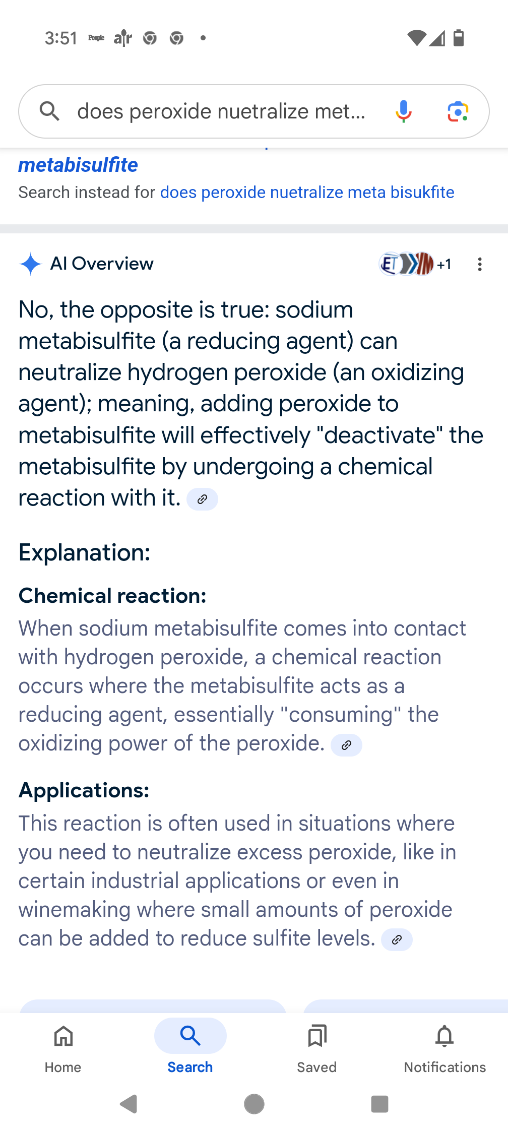

Did not know that about decaf...
Decaffeination process often removes a lot of the natural color so they add artificial dyes to give it back that dark rich look. We also find artificial dyes in some red wines. Often the vinter can't get the color they are looking for naturally, so they add a little coloring. Usually an oxidizer will work well on red wine but if you find you are struggling with a stain, try a reducing agent and see what happens.
