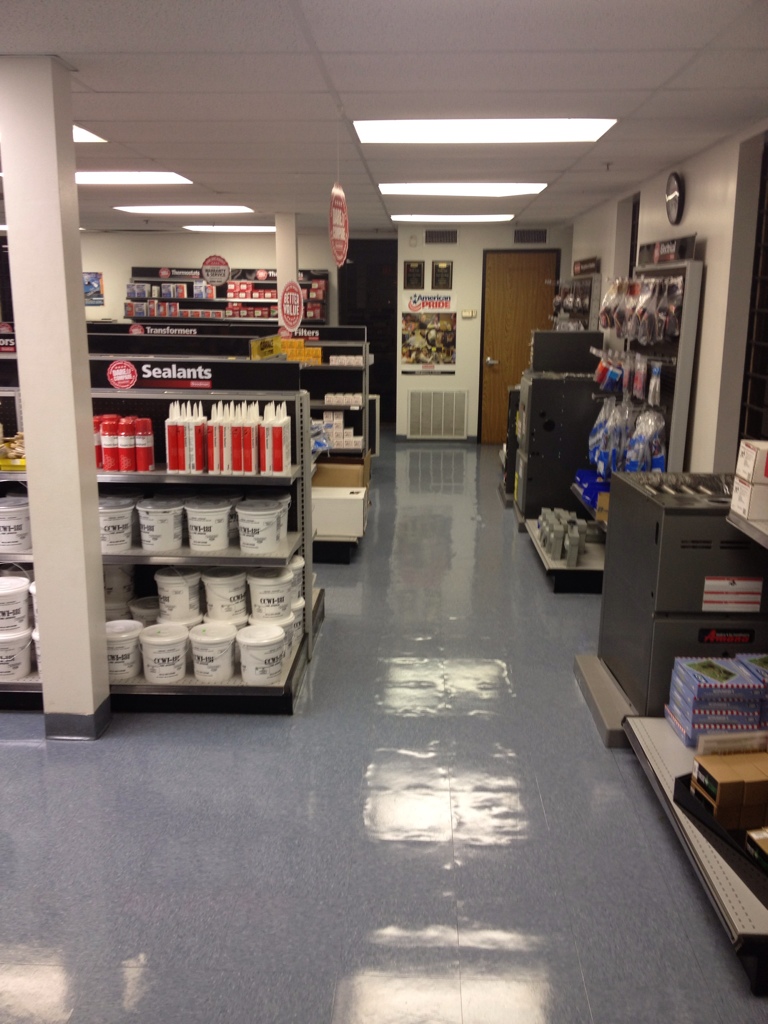

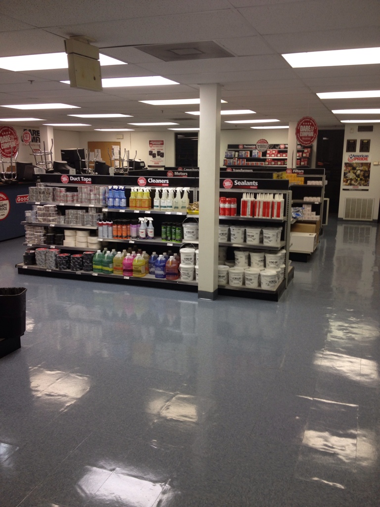

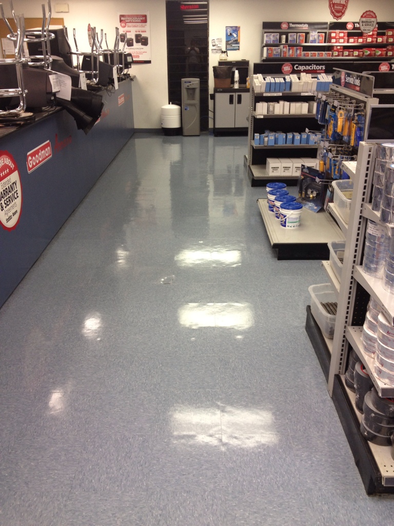

Greetings I would like to thank you all again from all the help and advice .I finish the job this past week end and here are the results.
Thanks

This was a small office was easy.
But I had some restrooms that was a nighmare.
I thought there wher esay ,but I had to strip them twice and work the edges realy good.
