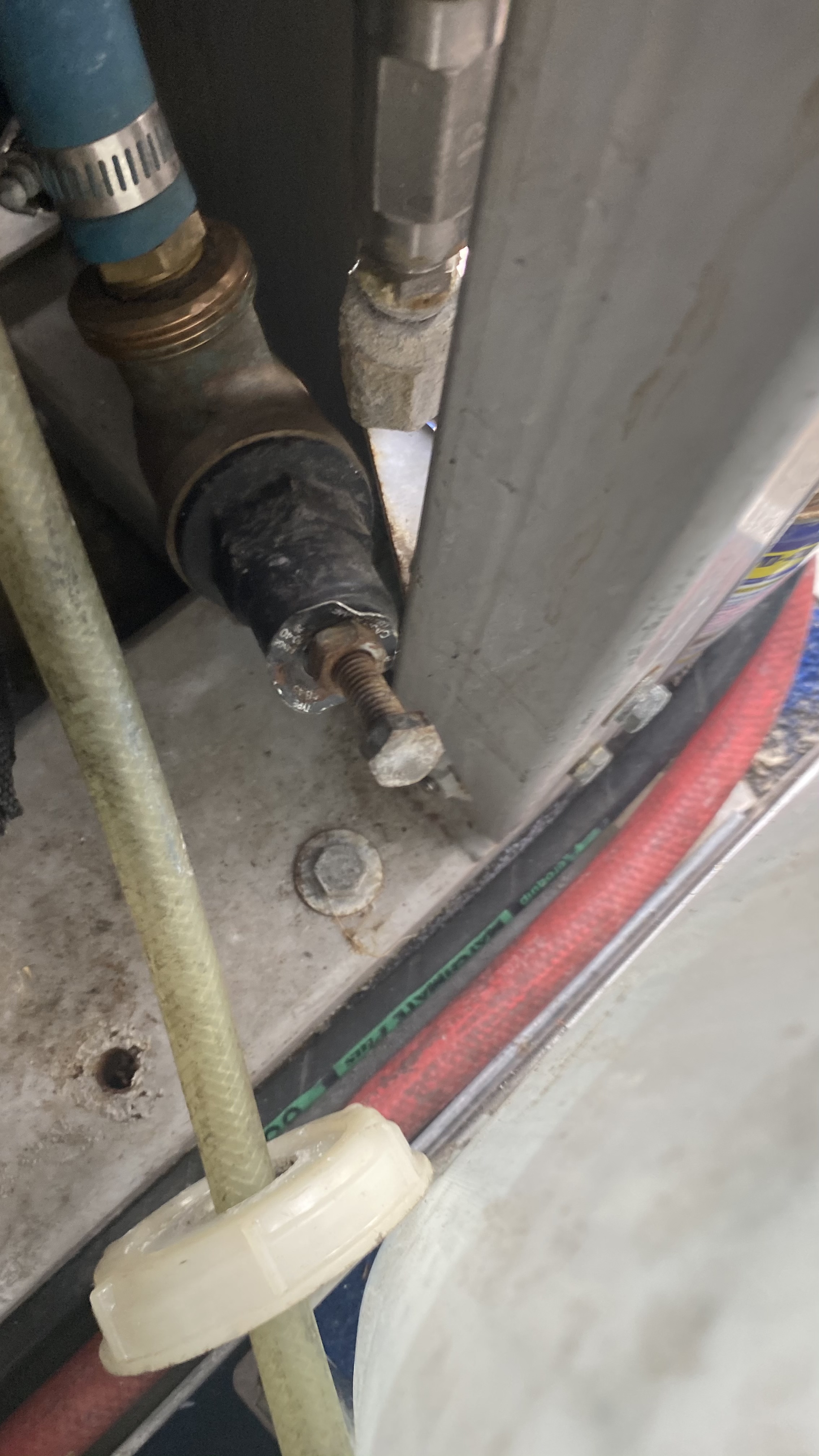

My truckmount has the original black bell housing type pressure regulator, it seems to be malfunctioning making the waterbox overflow full bore. When i went to adjust the pressure the nut inside the pressure regulator froze and stripped. I need ti order a new pressure regulator and i know there is an updated type out there, can anyone help me with a link to this? @Justin Legend Brands
107125 KIT, RETROFIT WATTS INLET REGULATOR.
You need the kit to swap it to the new style regulator. Once you have the new regulator, if it ever goes bad you will only need to replace the regulator, not the kit.

So the part number provided, is that the kit also? What is the kit number and where do i get that?
