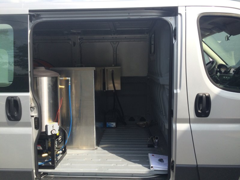

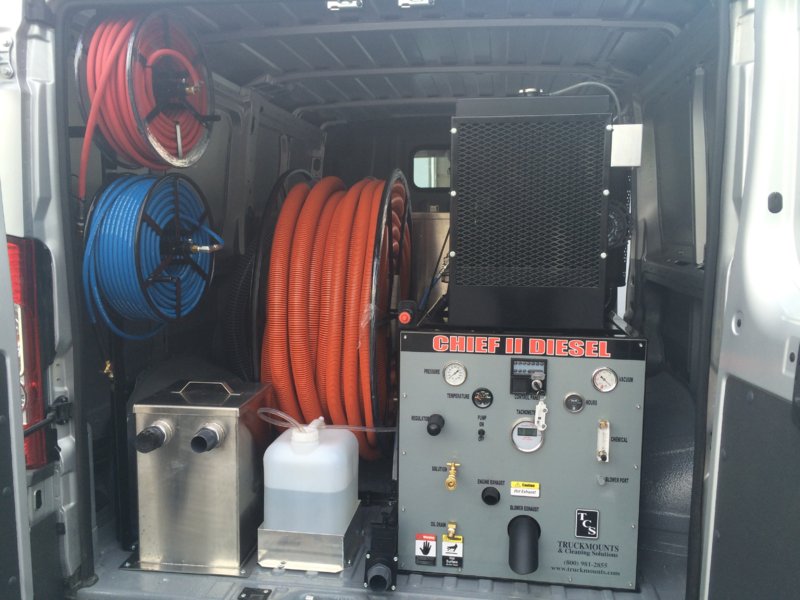

Well here she is.

Still have to get the shelving and other equipment back in. Went with a small fresh water tank for space purposes. Definitely will be a change but should be fine. Don't typically find ourselves without a water source. Headed to Germany for two weeks. Looking forward to using her when we get back.
