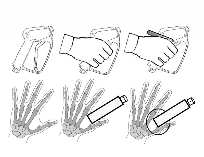

Thanks Fred for posting the videos. I just released it this week getting a lot of positive comments. As most of you know I made my first one of these ergo wand conversions four years ago to help with my trigger fingers. I would like to also thank Mytee for starting me on this journey. Because I tried Mytee's so called ergo kit & I found the more natural motion to be a plus. But, it just made my fingers worse. The problem was that the round nub on top of the gun valve rested all the weight of the wand into the web of skin between my thumb and forefinger and it cause injury to my thumb, pain and numbness on the top of my hand. That is how I came up with the only wand valve ( Patent Pending)that transfers the weight of the wand across the entire top of your hand on onto a special padding material. ( ) This pad make a big difference. You can even do a forward vac stroke with an open hand. ( try that with any other wand) I also decided that it would be helpful if you could choose your own desired angle for the valve ( An other first.) The more natural motion also allows for a longer wand stroke. Its all stainless steel and built for life. I'll have the Sorborthone replacement pads are available. I have a merchant site up- www.ergowand.com ( Still a work in progress ) But, you can place an order if you want and I won't run your card until mailing. So, this thing does exist and it solves many of the problems with existing wand valve systems. If anyone has a question I'll chime in & Once again thanks' all !!!

Why do you think existing pressure wash wand styles have not gained any traction already?
They have not gained traction as seen in the above post because they put the weight of the wand into the web of your hand and many don't have the most natural angle. On mine you choose your own desired angle
Are you convinced that the angle adjustment assembly won't develop some play over time and create a sloppy feel as you move the wand back and forth?
The angle adjustment locks down securely on a rubber washer. If the washer goes bad in time it is replaceable. I have spent a lot of time and prototypes on this feature. To find a washer that was soft/pliable enough to grab and still sturdy enough to last

Just an example of why other gun type
valves can kill your hand
