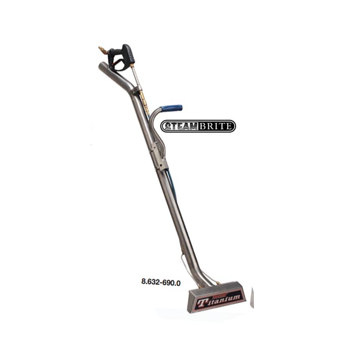

I had a Prochem Titanium wand, it was my favorite of all of the wands I had, even more than the Greenhorn. It was worth the money. It is a lifetime wand. I wouldn't pay $100 for a sheet metal ti wand, at least none that I have seen so far, they are too thin and flimsy. But a quality cast head....yes, it's worth it. Otherwise I would just go to quality stainless for a sheet metal wand. I don't think it's a coincidence that the two best selling glides we make are the Prochem Quadjet and the Prochem Titanium.
There is a reason the Greenhorn is no longer offered. And it's not just because Greenie flaked out. We lost money on every distributor sale and didn't make much on end users.....somehow Jeff always thought he could make that up in volume ( :hopeless:). It really should have been a $1K wand in order to be realistic financially. We looked for a long time before settling on the CMP wand to use as the base, the main things that swayed us was the heavy sheet metal, good welds which were smooth inside - where it really matters, and the "attic" in the head, like the Butler wands have, to more evenly distribute the vacuum.
I've watched many, many manufacturers release wands in different designs and materials - some with very innovative designs - but the fatal flaw in nearly all of them is an attempt to make them cheaper. Metal too thin, cheap components that break, flimsy aluminum or rotomolded plastic. If they just accepted that a quality wand is going to cost and realize that folks will pay it IF it really does what it's supposed to reliably. Sometimes it's better to aim for the top customers than to scramble and fight for the bottom.

I've never done a test but the PC TI wand seem to have very good recovery without the "attic" which allows it to under lower furniture which is a nice advantage.
Any reason, why it does well without the "attic"?

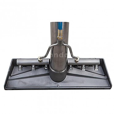

Jon-Don has this wonderful pic of the back side of the head of a ti wand:
http://www.jondon.com/prochem-titan...bnraWraarwxsPbvrVPaWARj3yENansZfbIaAi1o8P8HAQ
See the two chambers that stretch from the tube to the edges of the wand? They act in much the same way as the "attic". More evenly dispersing the vacuum.
Take care,
Lisa

Does the PC Ti have a bridge in the middle of the vac slot, in that picture it looks like there is a spot weld just above the lip under the tube??
Most of them do, but some people knock them out, the wand is heavy enough it really doesn't need it.

IMO, the CMP 14 has way more suck than the PCti.
It leaves the carpet drier, and if I hook both up to the V, side by side.... the CMP 14 is SCREAMING with Airflow (Both with Hybrid glides). Unfortunately the PCti is just plain easier on my back.
116,960
All 3 f my Ti wands sing a different song when hooked up Ashley.
Vac slot gap determines the pitch, not suction.
