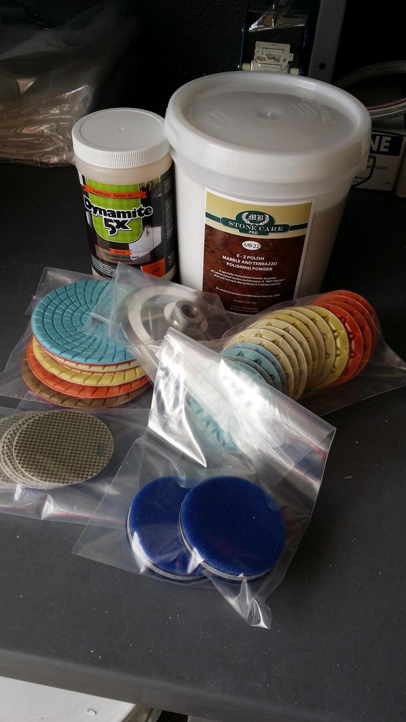

We recently had our Ultra Resin marble pads made into 5" hand pads for refinishing countertops. The pads that have been on the market for a while are very good pads, these new Ultra Turbos are significantly better. I feel comfortable saying that these are the bets marble pads money can buy.

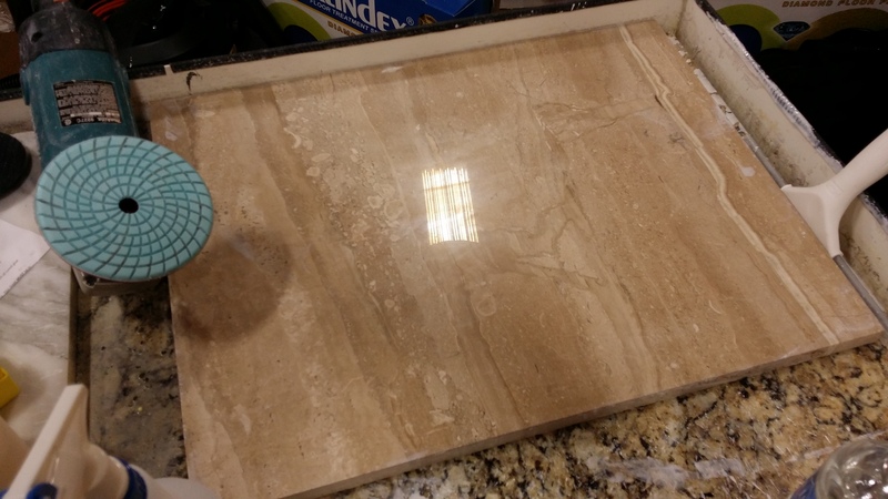

Here is Diano Reale marble, a medium hardness stone, after being taken to 800 grit.
800 grit, not a typo. These go to 1800 grit, no 3500 needed.

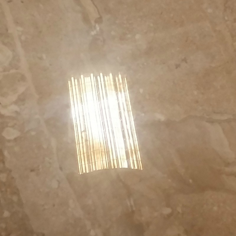

Here is the 1800 showing the light fixture in the ceiling at ICE, about 20+ feet above us
Here is a closeup of the 1800 grit finish.
Higher clarity and shine with one less step. We just got these in a week or two ago and they are now available. You can get them here: http://www.easystonecare.com/Ultra-Resin-Turbo-The-Best-Marble-Pads-p/5urt.htm
