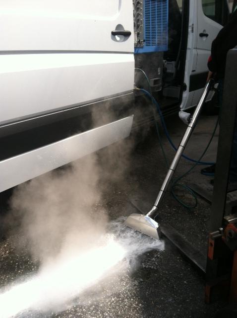

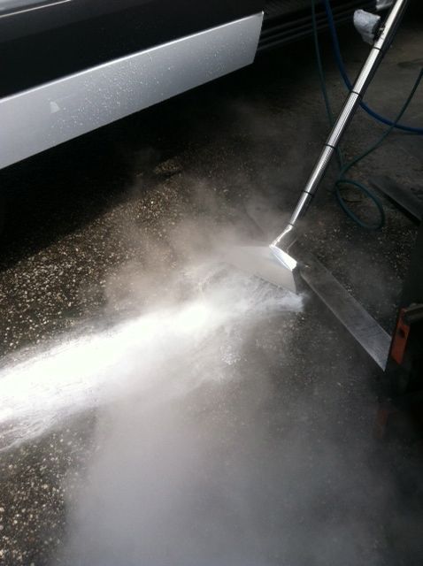

This is after running about 5 minutes. I was keying the wand 5 seconds on and 2 seconds off. The machine was on high. I fully believe I'll be able to maintain 230 degrees sustained. Its a beast. I'm like a little kid on Christmas :)

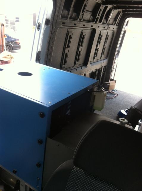

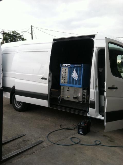

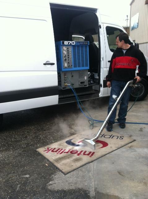

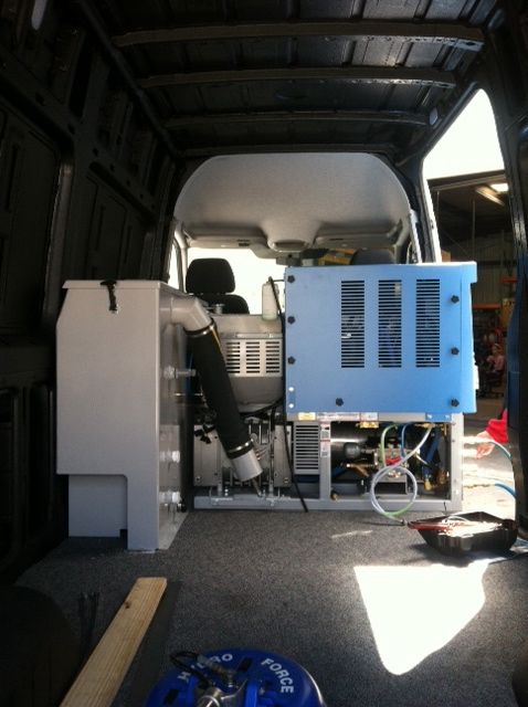

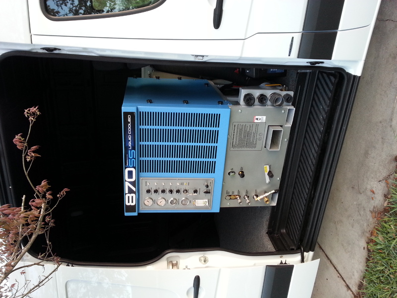

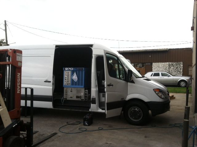

I will be posting more pictures soon but just the machine and waste tank are in. I'm putting the hose reels in tomorrow and my two 80 gallon fresh tanks don't arrive until Wednesday.

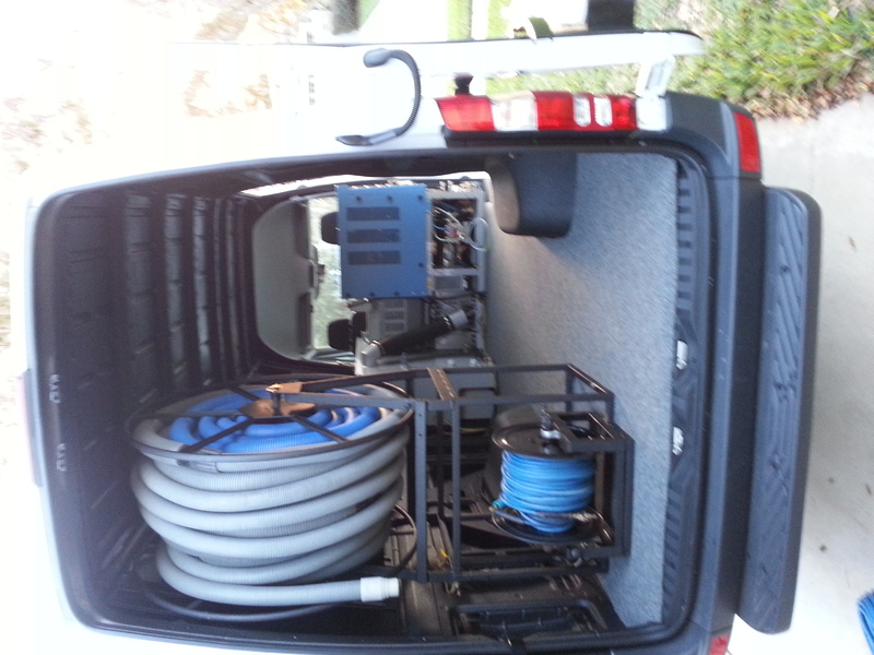

These are 300 ft electric hose reels.

Yes I did have the reels Linexed along with the entire 14 ft cargo area and both side of the marine grade plywood flooring. They said a typical linex job is 200 clicks of the linex spray system and they went over 1000 clicks on my job. I've owned 2 chemtex units, 3 hycalon hurricane tm's a hydramaster 4.8 cds, 2 pro-1200's and now the 870. Normally we'll bring multiple trucks to a large job but now we'll try dual wanding with the 870.
Zee
Nov 2, 2007
6,162
SoCal jungle
It's not too late to construct a platform that raises the machine up at least a foot higher and have useful space underneath for stuff or have drawers installed to hold smallish items...if you can, try to do a search on mikeyfest pictures and see Jimmy Olas' sprinter. He has drawers uderneath the blueline unit..its great!

What do you think of my live water hose attached here? I just used zip ties to hold it temporarily until I decide we're I want it.

I seem like a nice spot for it. As long as your not busting your knuckles on the reel below it.
I did like the idea of putting the drawer under the machine mentioned above, or a water tank if you getting one.
1,846
N GA
BradFenstermaker
Stagger the reels so you dont hit other 1 while rolling up. Vac reel should be fine with it mounted below. Sol line looks alittle too close stacked.
You can put hydroforce or something small that goes in every job under is stagger too. I try to keep all items that go in on every job close too eachother.

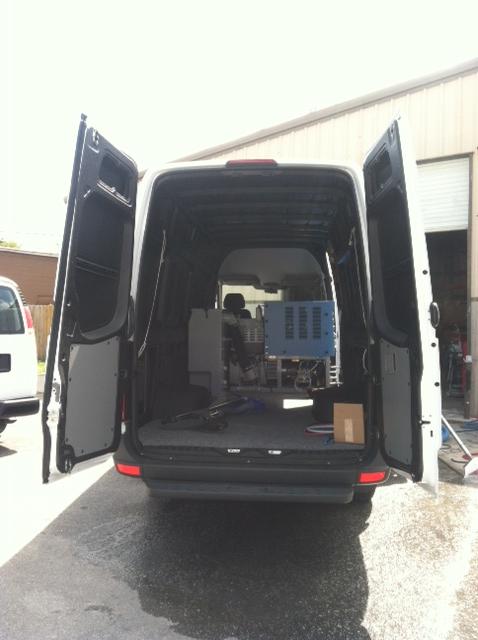

Dual 80 gallon water tanks just arrived, 160 gallons of fresh water if I need.
