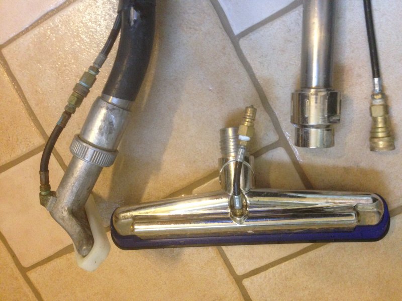

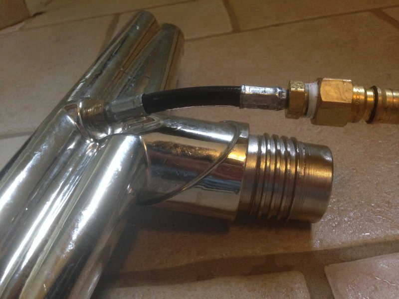

I'm liking this new tool. Been blasting through tile jobs that don't require Turbo Force spinner. Just spray, dwell and rinse at 1200 psi. Super quick. I was using the squeegee head before and it would lock down and become very difficult to use but the brush head moves like a glided wand. The quick screw on head improves on the weird slide in from the old design:

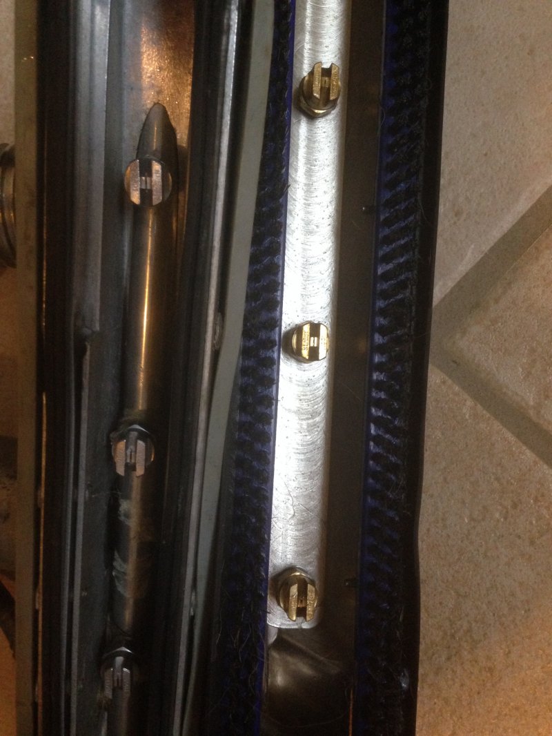

The new style the jets screw directly into the head instead of having a spray bar which fills with hair and debris:
