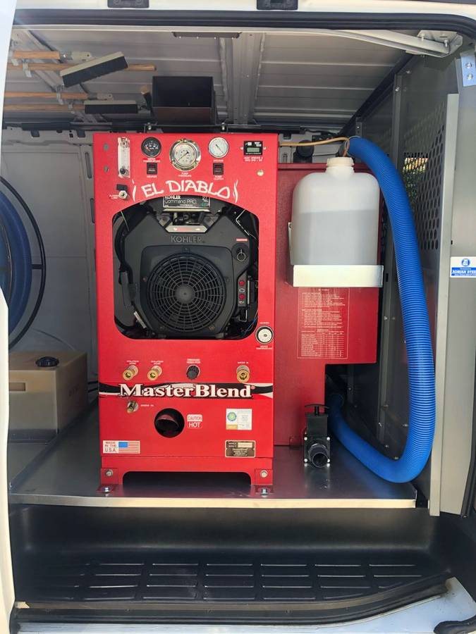

Forget I asked for that promo code lol I saw the option and figured I’d ask since a lot of guys here are friends with Tom. In other words, I took all of you guys’ advice and bought me a solid truck mount set up. Setting me back 25k, thus my “BDCC” attitude @Nomad74 😆

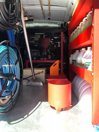

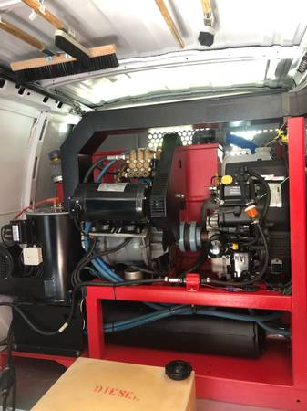

Hahaha fuuuuuck no. We got us a masterblend Diablo (2nd gen I believe?) with a 27hp Kohler engine, 45 blower and the diesel burner. 315 hours on it, and it looks brand new.

How many hours?
any chipped or rusting paint down low on the frame?

Just checked, 347 hours. And no sir, this thing looks perfect!

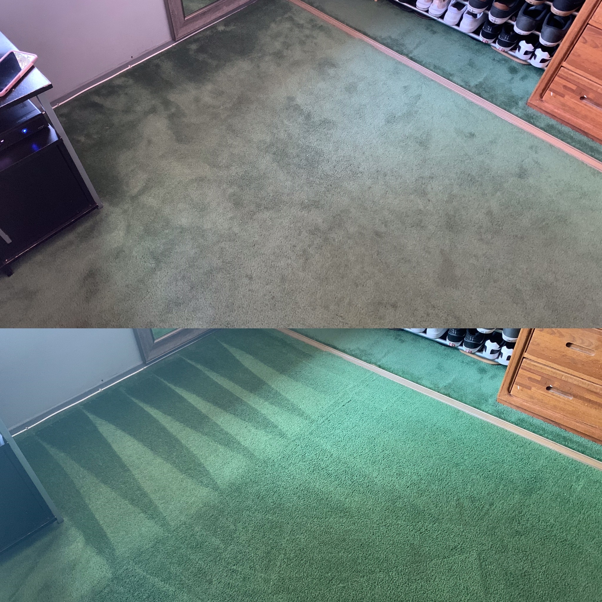

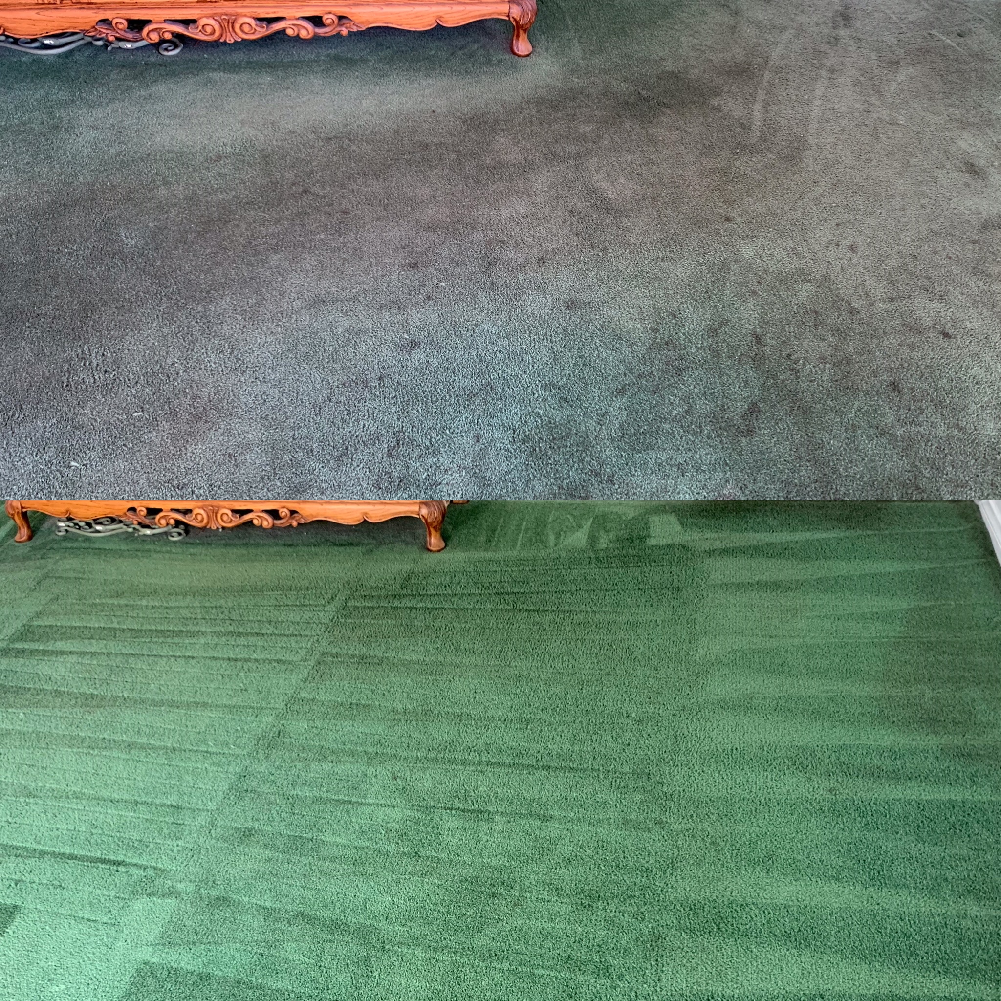

How’s it going everyone? Did my first cleaning today (my fam’s house) And for the most part things went pretty smooth. Something I kept having issues with was switching the solution line between tools. There was too much pressure to pop the line onto anything else without extreme force. What am I not understanding here?
Here’s a couple pics of the job too

Turn your pump off, release the pressure by opening your courtesy line or bypass, go inside and attach your solution line, go back out and turn on your pressure pump.
One thing to always check before you turn your TM on is that your valve is closed on the solution line. Turn the valve on after you attach to your wand.

You need to put plastic tabs under the furniture legs to prevent dye stains or rust. Styrafoam blocks under larger pieces.
