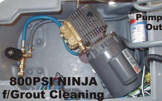

Willy;
One advantage our customers have liked is the noise reduction.
The covered cooling system for the vacs really cuts down the radiated noise.
There are some new 600+ airwatt vac motors that would really add performance and lift.
And a pump like this one:
Larry

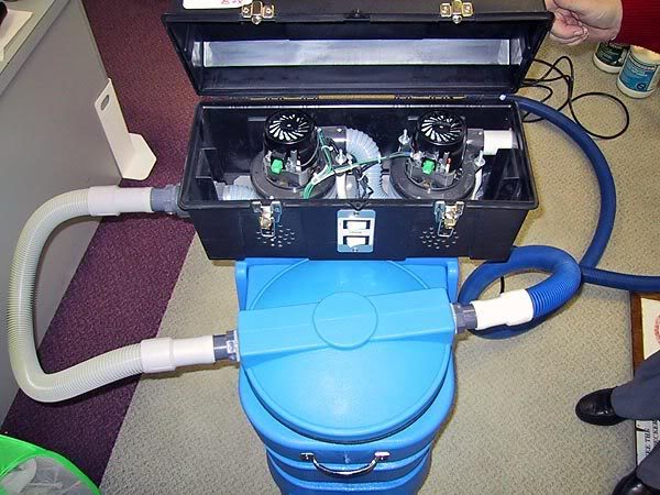

Absolutely Larry. Geez, you got me drooling... I saw the regular Ninjas and they looked anorexic next to the new model. I believe the head would accommodate a "tool box" vac booster by adding another hose barb somewhere alongside the other one. With that pump ..... :D :D :D ( See the pic below)That would give you 4 two stage motors and some pretty awesome power in a porty.

having that pressure regulator unloader knob on the inside would be a real pain!
It IS all about power with a porty. Being able to get as much vac and psi and heat without running too many cords. Was in a condo couple weeks ago and a Ninja 150 with heat (2 cords) kept tripping the breakers.
Got to be a way to make a porty run really well with just 2 cords, 3 max.

Ron, I run 2 cords for my machine- 1 on the kitchen wall/splashboard for 2 vacs , the stove plug for the pump and another vac and 2 cords for the heater and that's the minimum I can use to get enough power. If I go past 50 feet, another one for the inline booster. The inline heaters are a complete waste of time IMO as they cook the guts and don't have the wattage to sustain anything but a short burst of heat. I've experimented with everything and that's about it. ( I carry 275 feet of 12/3 extension cords :shock: ) The unloaders can be external mounts.
* One trick if you're having problems with the breakers is to steal a wall plug from the exterior hallway. They're generally, (but not always) 20 amp service.
