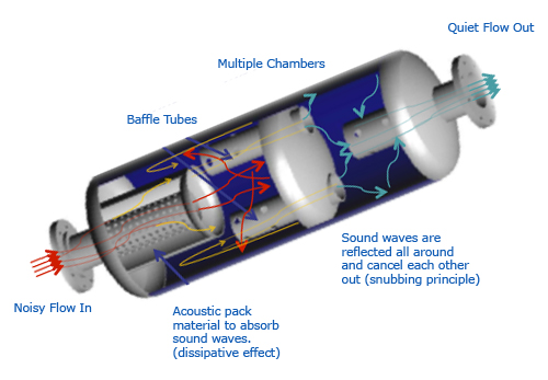

My understanding of silencers is that acoustic packing around the inlet knocks down the high-frequency component, and an expansion chamber (or series of them) takes care of the lows. The volume of the chamber(s) is dependant on the wavelength of the sound - so the lows require bigger chambers to be effective. This is why silencers tend to be so big.
It is possible to make a silencer smaller while attaining the same amount of sound reduction, but at a cost of increased pressure drop. It's always a tradeoff, nothing comes for free......
yep, that's what I said. Lol
