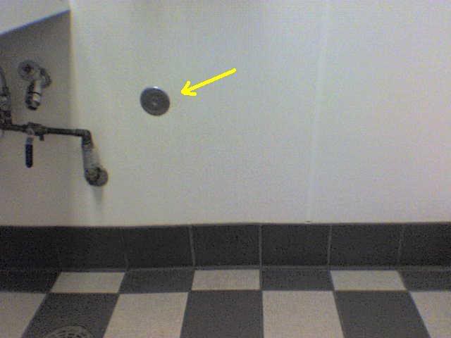

As for water supply-- Check with your local water dept. they may have a Fire Hydrant hook up for you to rent/buy. it has a water meter on it so you will be billed for the water used.
As for water disposal-- they can help you with that also. in some rare cases you can dump down the storm drain in some cities-- but this is rare- some cities have what is called a Shared System-- this means that all storm drain water gets treated before going into Ocean/lakes. If this not a option then dump/pump water into one of your other TMs and have them dump while you keep working? Or buy extra hose to reach toilet or clean-out pipe near any sink or toilet.
How about the rain gutters? where does that water drain to?-- into/onto the ground or the treatment plant.
