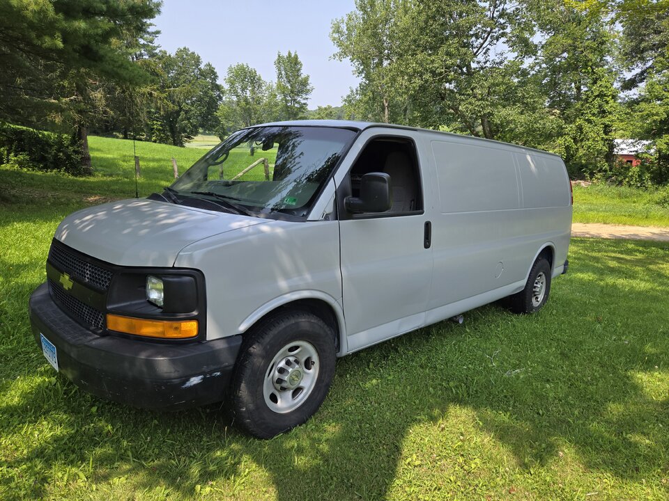

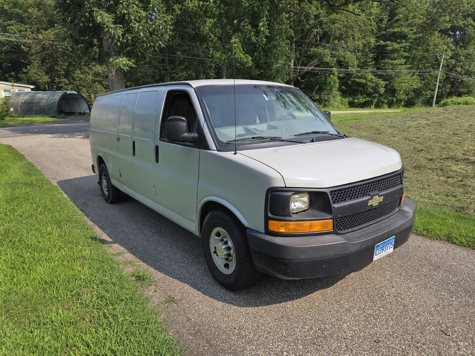

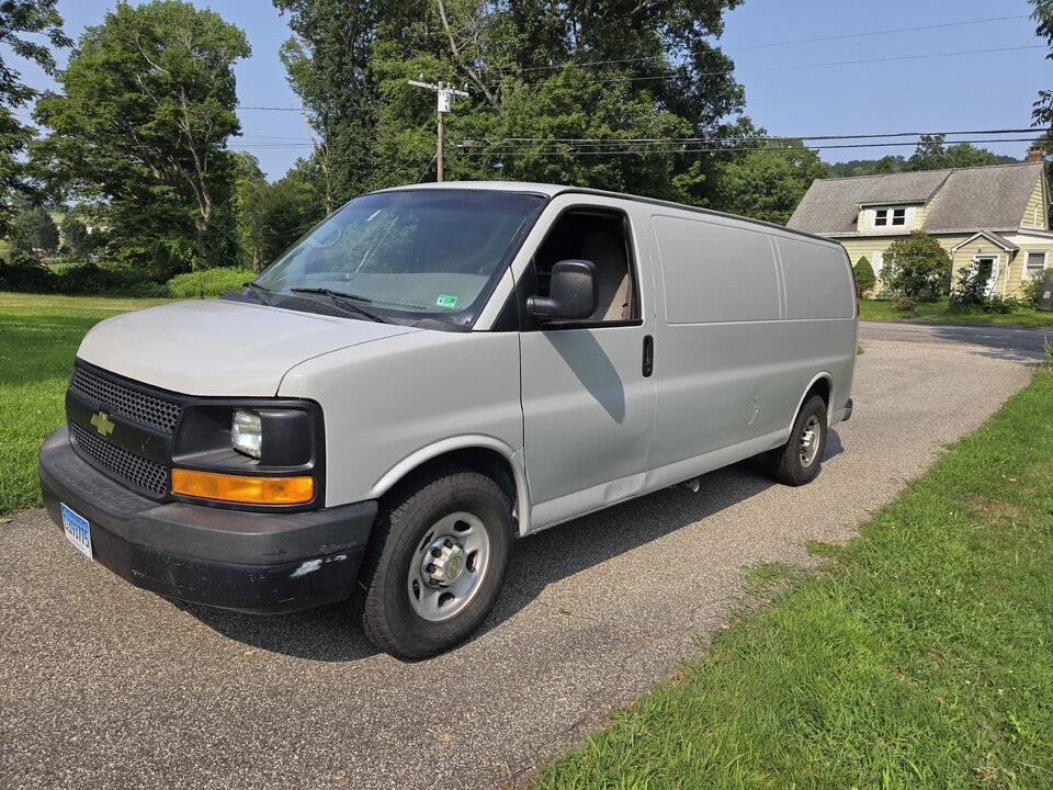

I painted my van. There were a few small dents I didn't fix but overall it looks and feels like a new van. Makes me happy. Hopefully the paint sticks!

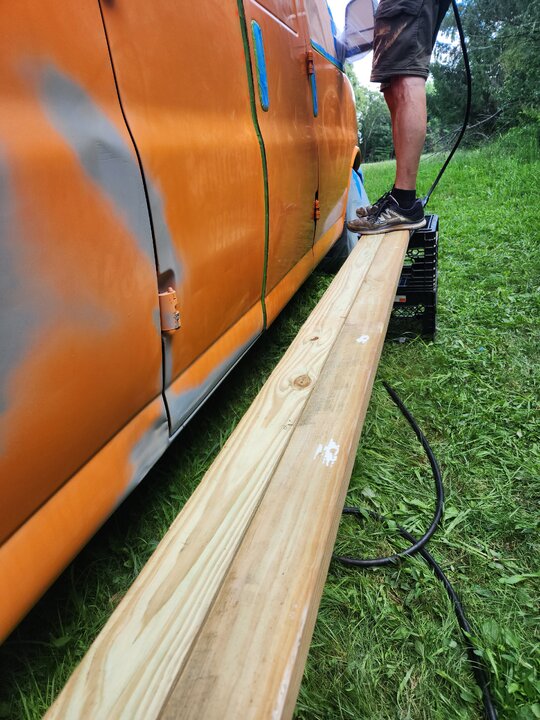

Hey Dwain thanks for the tip about spraying the top 1st. You were right there was no way I wouldn't be leaning against fresh paint and dragging my air line across fresh paint if I did otherwise. I made this really sketchy staging from milk crates and 2x4s 😄
I began washing and taping it at 8am and finished spraying by 8pm yesterday. That was a race. I had removed the decals and adhesives and scuff sanded the whole thing to 400 grit a previous day... 1 coat of sealer and 3 coats of single stage paint.
It was 77 degrees here and I parked it by the forest line behind my house so when the sun went over the trees enough by 3:30pm I began spraying. My wife had tweezers and was staying ahead of me plucking bugs and other junk off the fresh paint. She's a gem. I'm so blessed ❤️🙏
