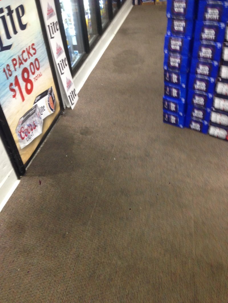

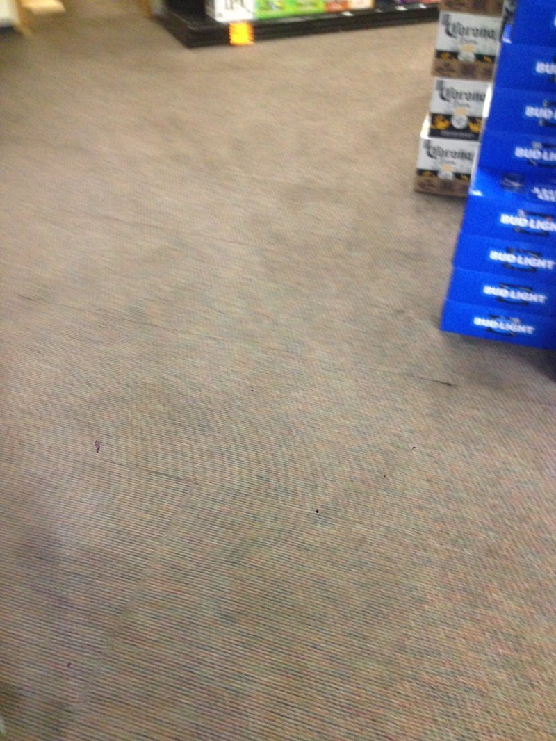

custy never calls for 8 - 9 months, place is a mess, then after a cleaning they on the phone 3 days later for wicking. Is it up to us to return and keep spotting, I know crusty is always right, they let it go!
27,866
Wicking, whether it's cellulosic, dirt, blood or whatever is always the result of incomplete cleaning or drying. Yes, you can charge extra for some of it.

I know we need to go back, it's a retail store. The wicking is tricky, you leave and the place looks great.
I hate the call because it's never a good feeling.

It looks like you are dealing with some liquor spills of some sort. All liquor has some sugar content. I have had good success bonnet buffing using a mixture of neutral cleaning solution, soured with browning treatment or citric acid. When you are done, spray some browning treatment on any visible stains lightly.
Looks like they don't even vacuum. You need to charge for this job like you're going to have to clean it twice or maybe this is a job you are better off without. Firing some customers is sometime necessary to you grow your business.
I'd try some encap if you have a floor machine. Even encap and a towel could help. Anything to not have to set up a porty.
Even some peroxide can make the wicking/water rings go away.

I did go back, of course the floor had more than just some wicking, I told them I can take care of a few but I'm not doing the whole place over. They agreed and I went back, then I went back a week later and it did look good for the spots I hit, the owener was there and I try to explain that if he keeps up I can get it done and it's a work in progress, he agreed and now wants me every month. :) he still thinks I'm not really hitting it with the proper pretreat. I showed him some photos of the before and after, he knows he waited to long last time ( 8 months)

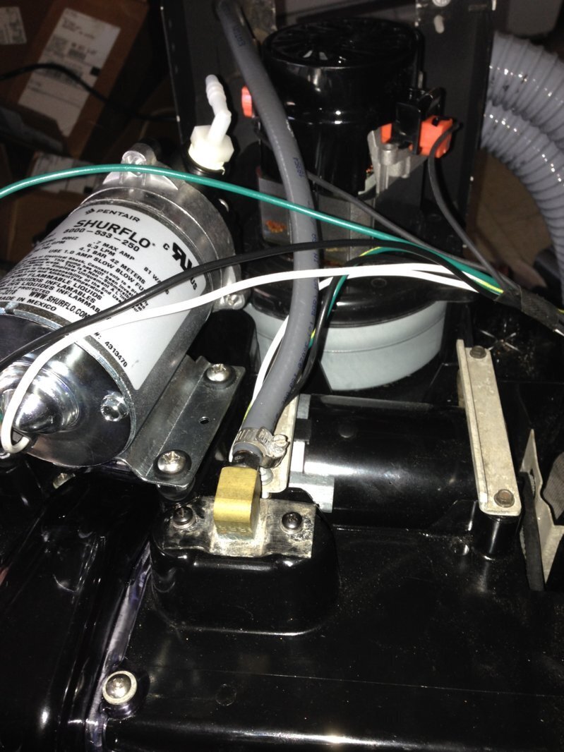

Looks like I'm not getting any spray not sure what's up, pretty much had to use a mop to get the rinse out today, I checked the screen, it's clear, the hoses look good under the hood, I must be sucking air, no pressure. Just goes to show u it's always something.

I don't think it's a clog, there is like nothing coming out, everything is new

27,866
take a short hose with a quick connect on one end and open on the other. Attach it to your pump connection and put the other end in a bucket. Make sure there is water in the solution tank. Turn on pump and see if you get anything out. This is called bleeding the pump and should be done every time you use the machine before you hook up your wand or other tool. Let it run until you can see that there is no more air in the stream. Now the pump is ready for use.
I thought this was a self bleeding system,
