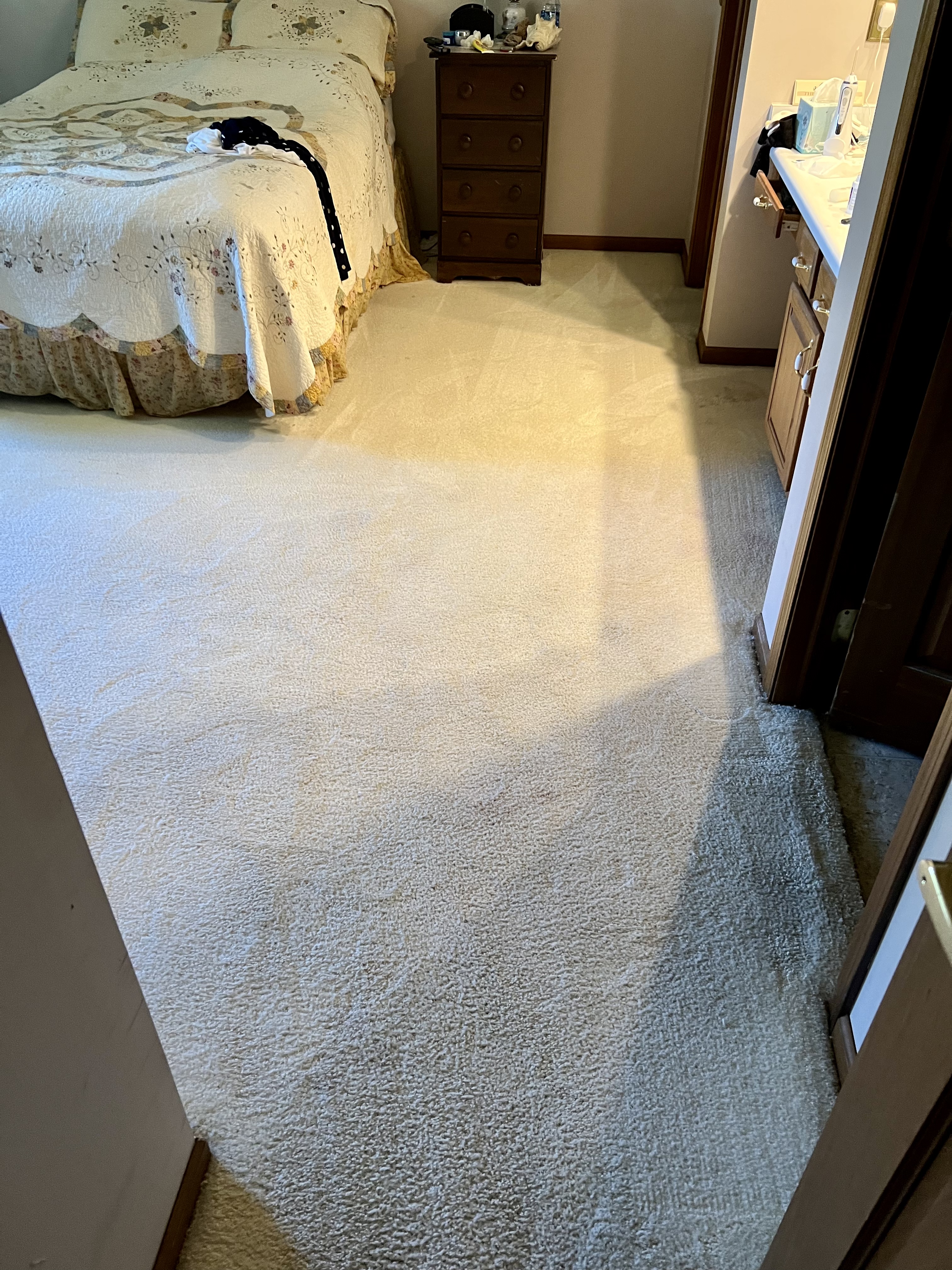

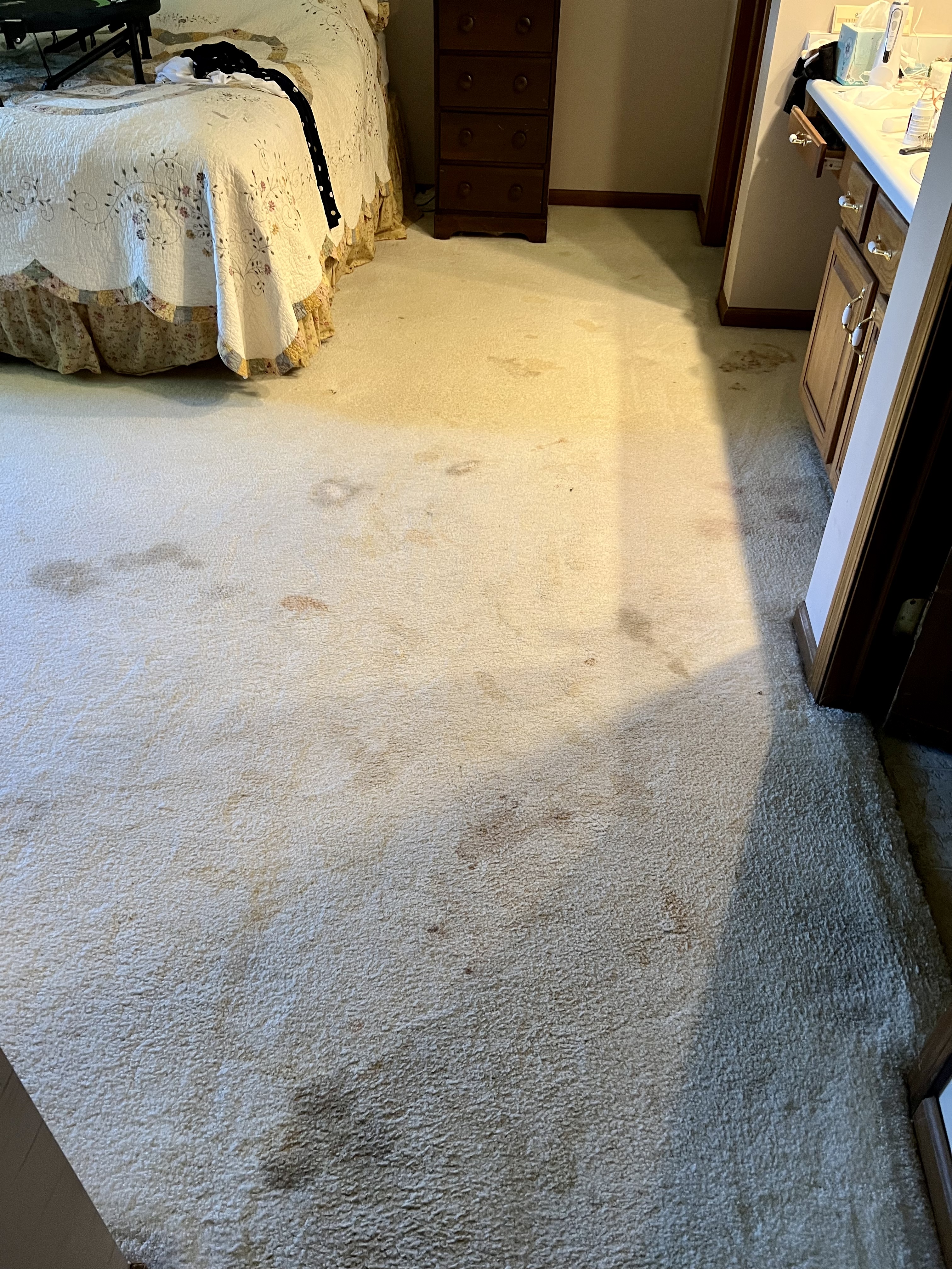

Old lady, cat room (puke).
Odyssey
PCP, TOPS Spot, sodium chlorite & red out
Scrub pad
3 Glad pads (until the pads weren’t dirty)
Yes, I rinsed after this pic. My waste water wasn’t anywhere near as bad as I thought it would be.

Responding to an accusation with a question is a sure sign of deceit.
Is the accusation you assuming I just smeared around all that cat puke? Did you the miss the part where I rinsed it with hot water?

It means you don't like his response so you're trying to reframe while pretending like you're sticking to your original point.
He's positing that though you may have given it a uniform (dingy) appearance, you didn't get it clean.

And I scrubbed with the Trinity, two different pads and then rinsed with hot water. Pretty sure it wouldn’t get any cleaner than that. She got a Hella cleaning.
It’s also carpet from the 90’s.

great job but I would have done a quick rinse first. Probably would have taken most of the spots out.
I do that when there are multiple spots or large spill/spots. Rinse most of it out first so you dont get it deeper into the carpet or worse, spread it around. Takes only a second to do and makes your cleaning agent much more effective.

I was experimenting with VLM. I knew it was going to be rinsed.
This was about showing what the Odyssey can do by itself.
There was no actual puke on the carpet when I got there… just the stains. Her neighbor used a brush and Green Machine prior.
