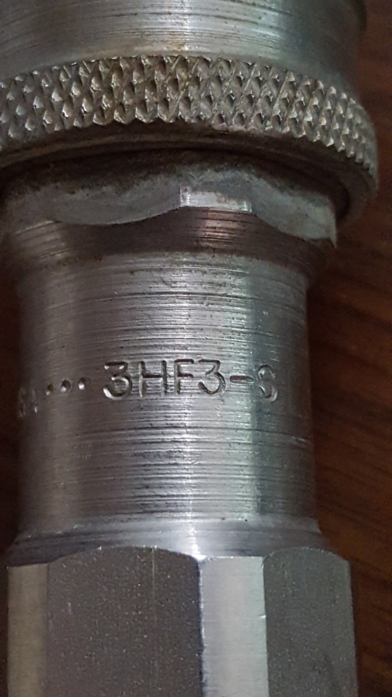

So yea, my fancy water supply quick connect now leaks, bad. My 45$ quick connect cant be garbage?
I know the rings inside can be replaced. How do I find these are they a "special" type (can I go to ace?).
Seems like they would be easy to get out. In, not so sure. Is there a tool I'll need to get?
https://www.dixonvalve.com/product/3HF3-S

You might start with Dixon to find the part number, or just pull one out and compare it to others at the o-ring store. I took one into a local gasket maker and didn't worry about rubber type. My guess is their Buna.
Use a large safety pin or anything pointy to stab the ring. Pretty easy once you get the hang of it. I make all of our guys practice changing o-rings; I won't tolerate leaky fittings.
PS: Make sure you polish the "drug it on the sidewalk" spikes off of the male fittings. That's what destroys the o-rings.

Quicker to change the o-ring than swap out the fitting. Why waste money on a new one?
If the o ring is worn generally so are the ball bearings. Then by the time you go buy a pick, O-rings, lube and your time to monkey with it where is the savings. :shifty:
It's a 45$ and stainless, you guys throw that shat away???
Two o'ring are 1.60$...
