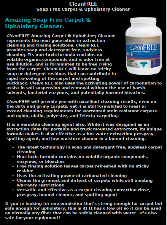

Soap Free products, of which most manufacturers have an option, fit into this category. Our product is Clean Free, but it contains sodium tripolyphosphate which is not environmentally "green" but generally regarded as safe to humans. The pH of Clean Free is also above the pH standards for wool as ours is around a pH of 10. My guess is that none of them officially meet all four of the criteria stated in your topic heading, which is really hard to formulate in a powder. The best performing powders will generally have some phosphate in them and will have a pH higher than 8.5.

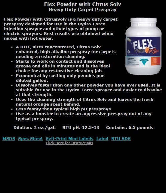

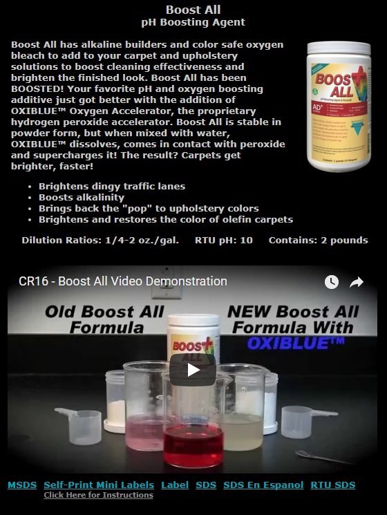

We're going to use the Clean Free on the carpet at the RMH/Vegas and Flex/BoostAll on the tile

Redline similar to Code Red?
Redline has delimonene and enzymes, yet is 10 ph, which means that uou are not violating the manufacturer's warranty.
Works very well, reasonably priced, rinses well and does not foam like Flex or some other products.
It's a MasterBlend product.
112,701
Flex foams?
when?
With our VAT waste tanks, you'd never know.
San Francisco, CA
Unfortunately, or in S.F rather fortunately I do not own a VAT.
One extended sprinter parking experience extravaganza, was enough for moi.
Yes it foams. Not terribly but it does.

The original Flex liquid used a surfactant that could have foam issues. We changed that many years ago in Flex liquid. The new surfactant blend limits that issue to carpets that have a lot of surfactant residue. We use the same surfactants in Flex powder, but the d'limonene (solvents in general) limit foam issues to pre-existing surfactant residue.

It could be related to previous residue. I didn't do a scientific side by side experiment. Just noticed that in general it foams more than Redline. Not terribly, as to cut vacuum power, but noticeably more. I wonder if others had the same experience.
I use the Flex powder. Dissolves exceptionally well.
