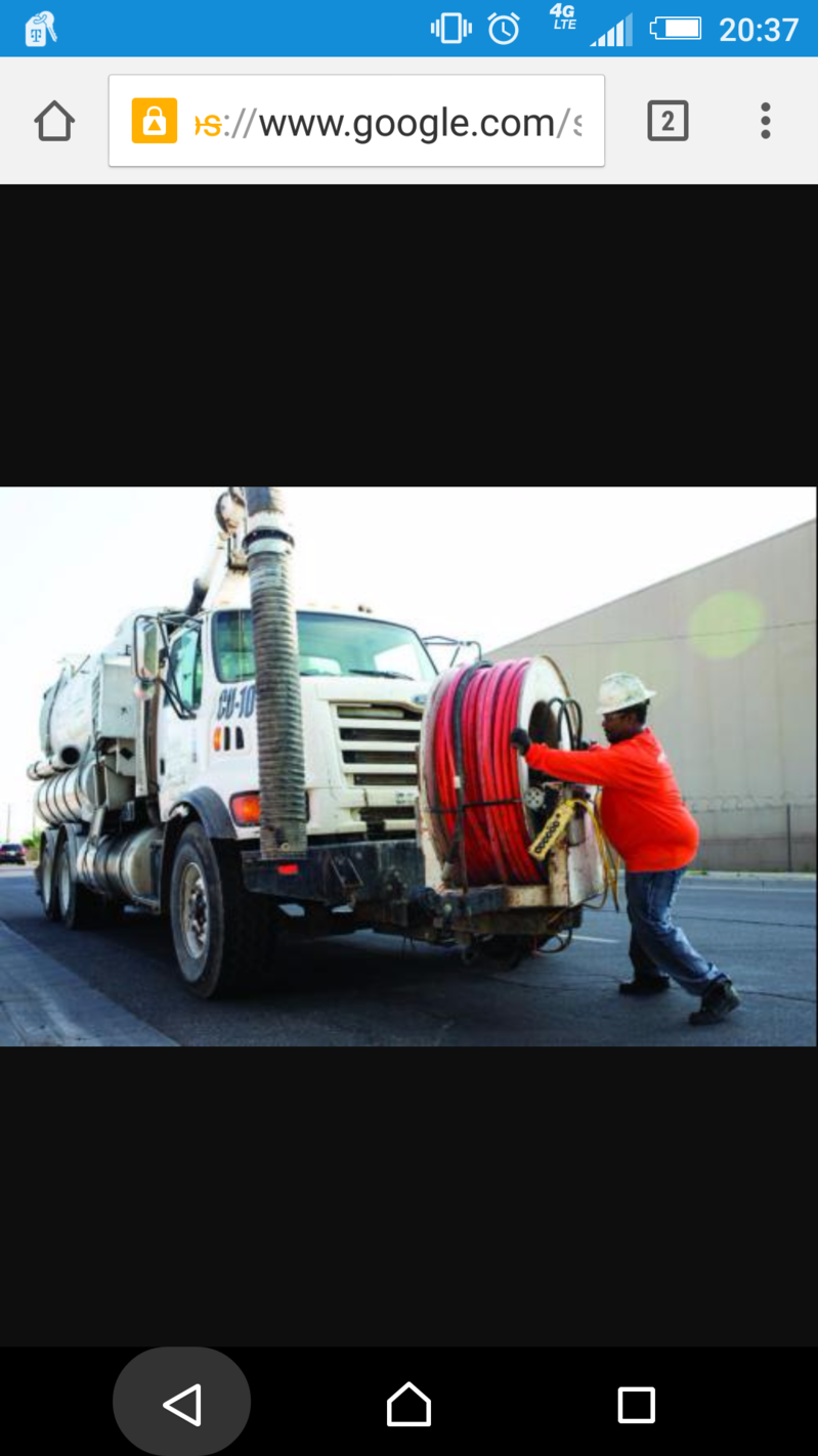

I'm wondering... Why can't we have outside hose reels mounted to a rear of the smaller vans? We could have them on hinges and swing them out of the way. I'm thinking mainly for the vacuum hoses. Since that's what kills most of the space inside the vans.
It could be completely covered so road grime, rain, snow, won't be dragged in the next house.

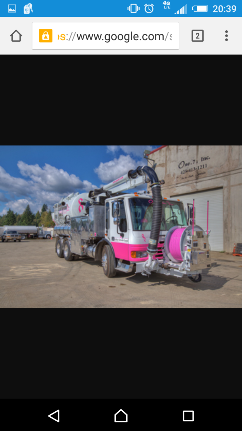

Imagine something like this but on the back.

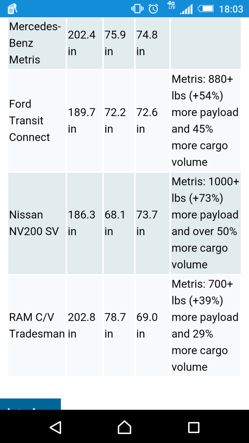

I'm really liking the new Mercedes Metris van but it's a bit smaller than the Econoline 150 (to be more precise it's 50 cubic feet smaller. 186 cubic feet)

BTW, to those of you who think the Ford Transit Connect and Nissan NV200/Chevy express is the same size as the Metris
No

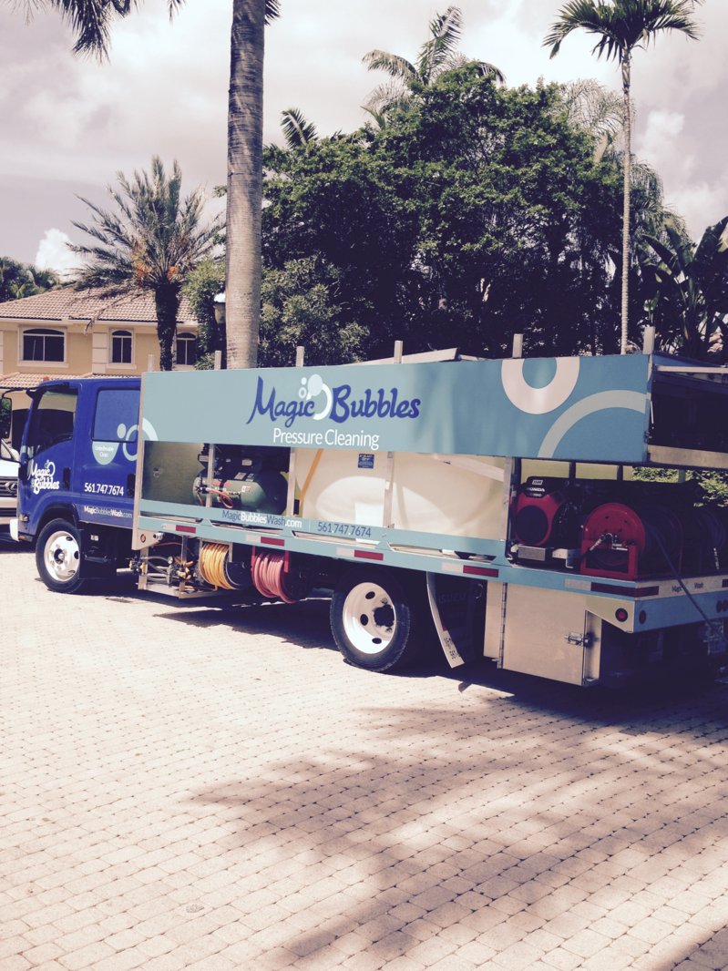

I have a hose reel under the passenger side of my box. Works great and I have room for more. Check this rig out

I solved the heat issue by putting a door on the opposite side. Also makes working on the truckmount super easy. As far as the reels All the pressure washer guys here with big trucks run like this. Seems really smart to me. I haven't talked to one who has lost a hose. It doesn't want to spin when mounted sideways. I have my garden hose under and it works great. It has a lock plus we wrap the hose. Probably going to add a spool with 3/8" for higher flow.
