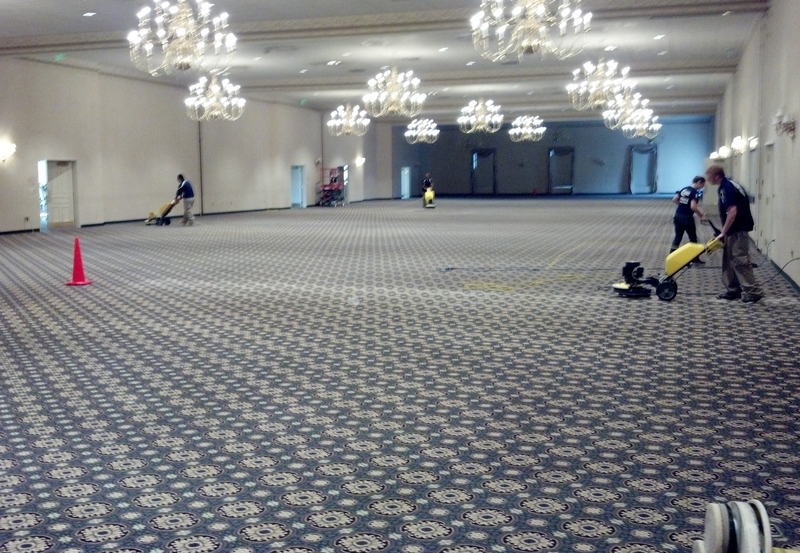

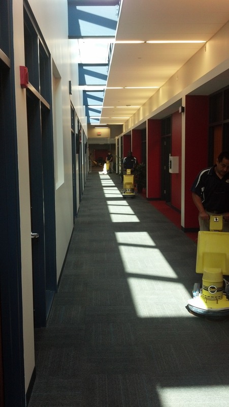

We dual Cimex large jobs...
Two Yellow devils running and sometimes a 175/cotton following both to mop up the slop
We've used the Cimex to breakup some greasy carpet and padded after it. There was no apparent advantage in time savings or improved results. We only did it once and haven't tried it since. Generally if the project is large enough for additional equipment we just run another machine.

Yes we have those jobs too where 4-5 Cimexes run and a couple of Orbots as well...

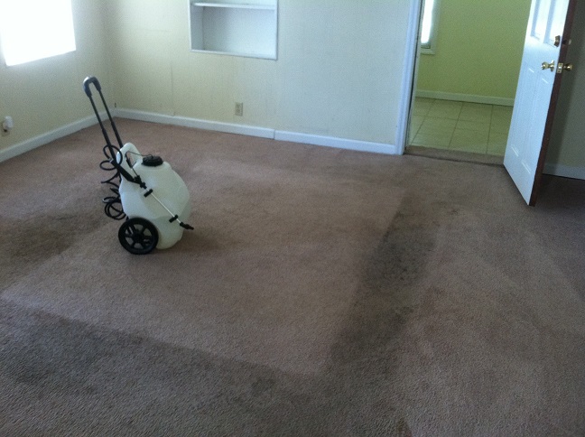

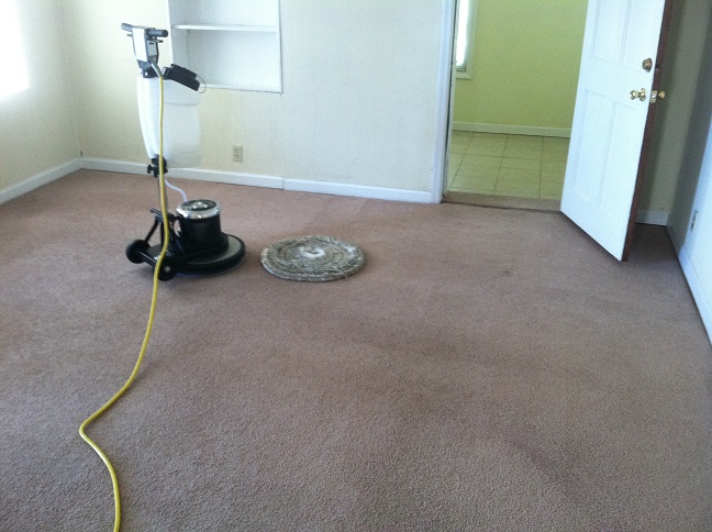

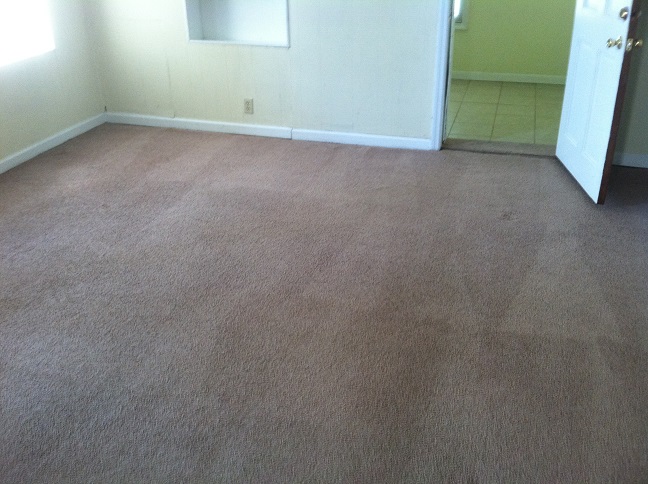

I can see the benefit if you using two different types of vlm machines, when using a rotary I scrub with a vct pad then an absorbent pad, so it's easy and quick to change.
This a one of those poly carpets that doesn't want to come clean, I pre sprayed with Procyon Extream, scrubbed with a burnishing pad then
removed soil with a loopy microfiber pad.
