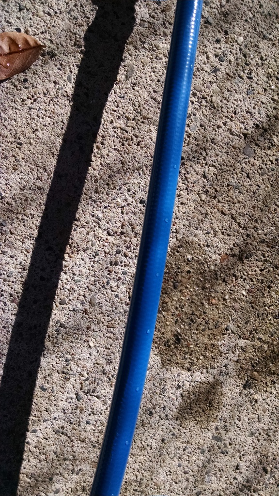

Has anyone had issues getting new Parker parflex with holes in it?
jmo
Apr 11, 2011
350
Tucson, Az
Jeremy
Not sure if I should cut off the bad part and recrimp or if it's a sign of a bad batch of hose and send it back.

Not crazy heat I haven't even used it yet just put it on and flushing out the air and noticed about 15 pin holes.

I ordered some from John, and mine did have some leaks, I ordered it with no ends, and I put my own ends on. I believe I didn't get them tight enough because the hose was leaking about 3 feet back from each end. I cut it off and redid the ends and no more problems but it looked like this.
Tiny little beads of water every 1" or 2 very evenly spaced, I didn't bother calling John about it, after the new ends fixed everything, I think it was letting water get between the inner core and the blue outter wrap.

Ok good so sounds like I just need to put on a new end and it will be fine. Mine is spraying and has the the little droplets coming out like tconway

I have a little video of it, and the end that was hooked to my TM was actually misting from the pin holes. So yes I think you just need to cut a bit off to be safe and re crimp with a little more CRIMP good in tight.
