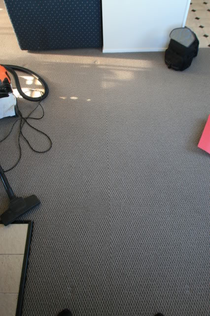

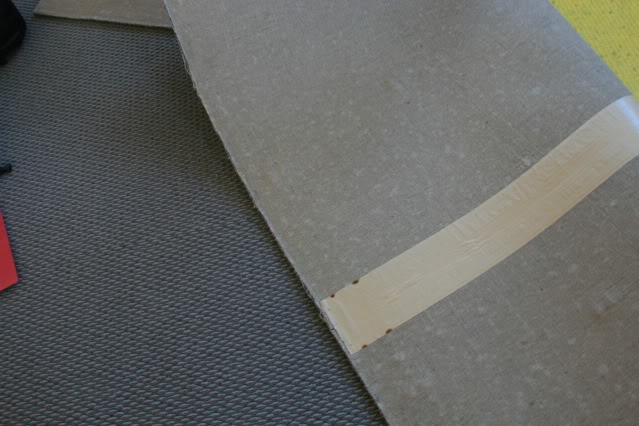

Layer got uneven stretch between the dining room and lounge room and ended up with a pattern mismatch on the seam. Client went ballistic for 3 months trying to get the retailer to honour his workmanship.
Eventually, they sent in a fault request to the manufacturer and the head rep inspected. Agreed to send me is 'to see if anything can be done'.
Yeehaa, he's used KG.

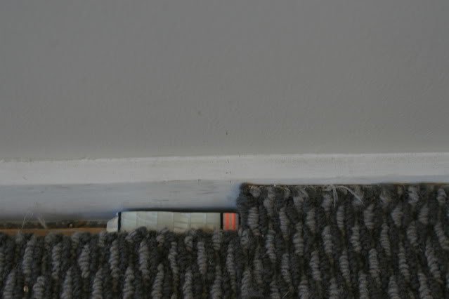

Close to an inch on the repeat :shock:

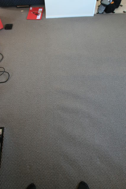

A bit lumpy... lucky I had the right ools for the job :wink:

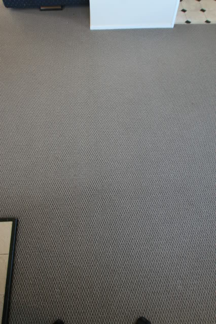

And finally, stretched in with teh power stretcher.
