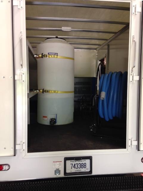

That tank has 2 massive ratchet straps. That tank aint going nowhere
BLewis
Jun 17, 2008
1,693
Billy Lewis
The straps are rated at 1,000 lbs each with a brake limit of 3,500 lbs each, plus I am going to have a ring containment base fabricated for the bottom that will be bolted to the floor. I chose this because this box is only 12 ft and I needed the extra space. It will be OK I'm confident

Did you get anything fabricated for the bottom? Or just strapped in
I originally had a stanless steel frame built for my Everest to Set-on. I told my supplier before hand. They said ok than when they say how high the machine was going sit they said no. Crap I was out a grand for the tank and a grand for the frame.
The only way the tank was going to fit was upright behind the hose reel. I used the stanless steel angle iron that was used to build my frame and bolted it around the bottom of the tank to the van. I than used 4 heavy duty eye hooks bolted with very large washers through the bottom of the van and two of the biggest racket straps I could find. I think they are 10,000 lbs a piece. Lots of weight on one side but I have not notice any problems.
