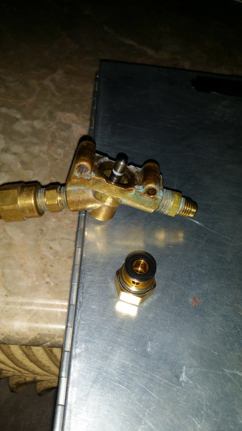

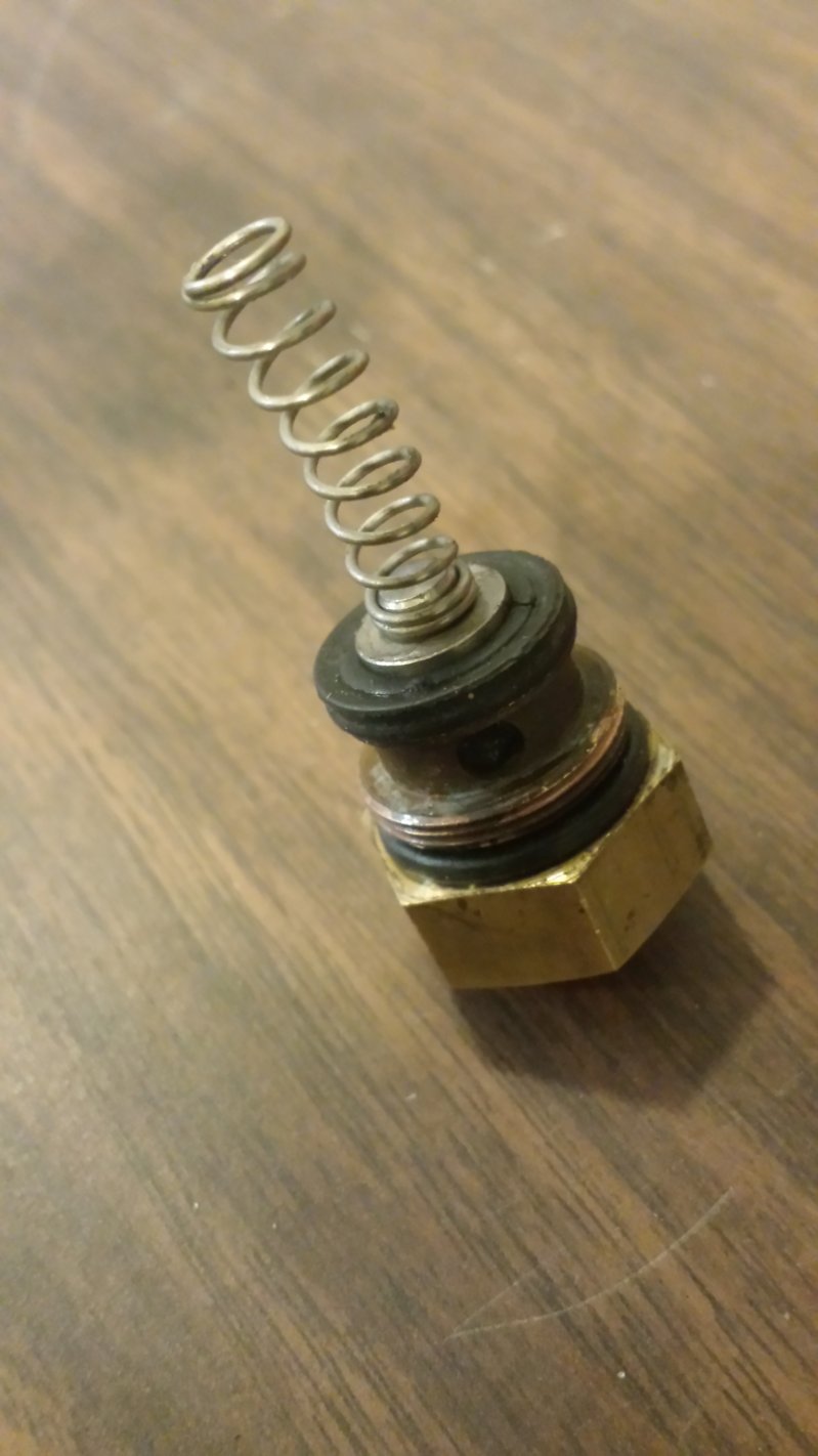

Trying to install replacement valve for wand....3 hours and im ready to scream...bottom O ring keeps moving...I cannot believe it's this complicated..everytime I reassemble it...the stroke is short and once I spray...it gets stuck....I've assembled this upside down and rite side up....im frazzled

No, nothing is missing...I ordered 2 and THEY are both the same the problem is is the bottom oring keep sliding out of place

it helps the piston move freely. You might try it and see if it helps. I have a diagram on my work PC . I can upload it tomorrow if you would like to see it. Is that split teflon ring on the piston?

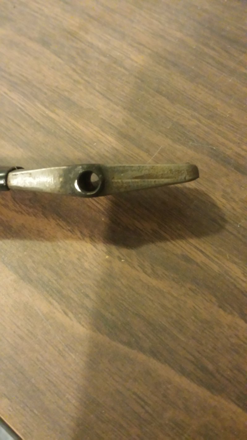

Make sure the flat side of the Tigger is pushing on the plunger..

OK its 4:45 AM and I am up trying to figure this stupid valve out...I am going to admit....I GOOFED....finally realized there's only 1rubber washer..I had 2 in there...Boy do I feel silly...although I've never even opened one of these valves...Thank you all for the help...I believe it fits just fine now
