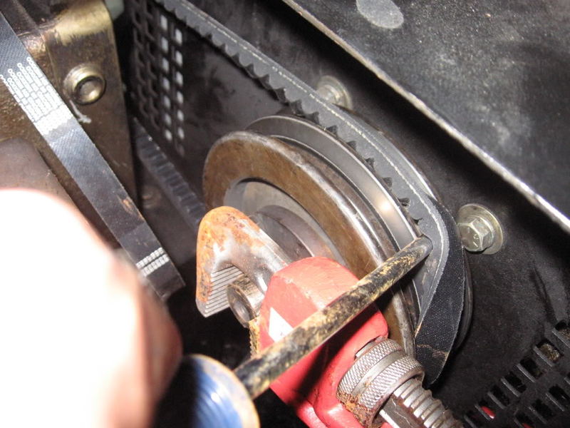

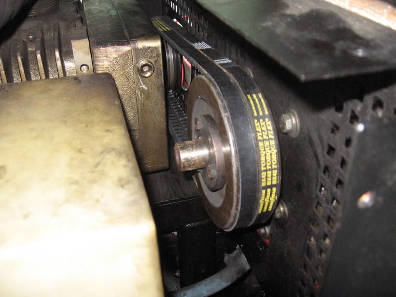

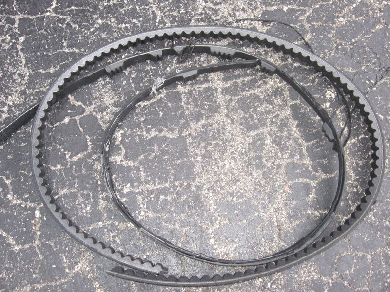

Well, my belts finally went out after about a year... they use to go out every 3-4 months before I converted to 2.5. While I was working I could smell burning rubber so I shut it down and cut off the bad belt. I was going to replace them on the job, but figured I would try and finish with one belt... It made it. Maybe you guys are doing this already but it beats the hell out of moving the blower.
That one belt looked pretty good yet...

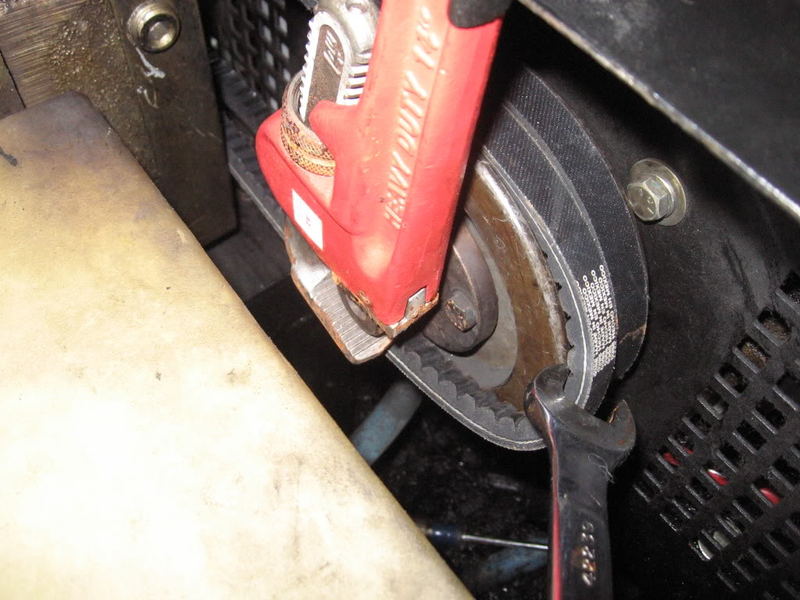

Make sure you hang the inside blower belt first. Step the first belt over in the shive groove.
Step it over again..
Do with the second one thats hanging on the blower..
And your done, saved some money, and down time.

I wonder if running two different belts had anything to do with why one was toast and the other looked good?
I was wondering the same thing... the one that looks good was cracking looked like dry rot, but would have lasted a while longer. That tore up belt was the furthest away from the exhaust.. :) I hate when they go, what a mess!

I do always replace both at the same time since when one goes it usually takes out the other. At the time I bought the last set, the first place I went to only had one so I bought it and picked up the other somewhere else(two different manufactures though).
I do check them for wear every now and then, but it seems they just go... No inside wear at all by the looks of them.. The thing that bothers me is the look of the "good" belt, there is nothing to show that it is wearing uneven but looks like it dry rotted.
