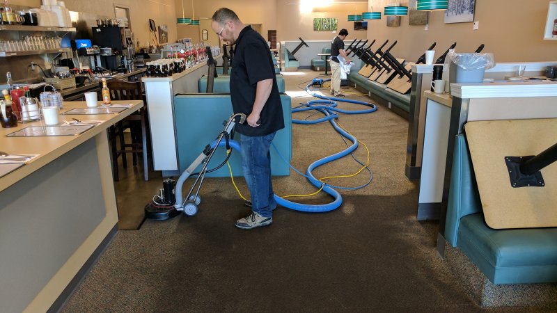

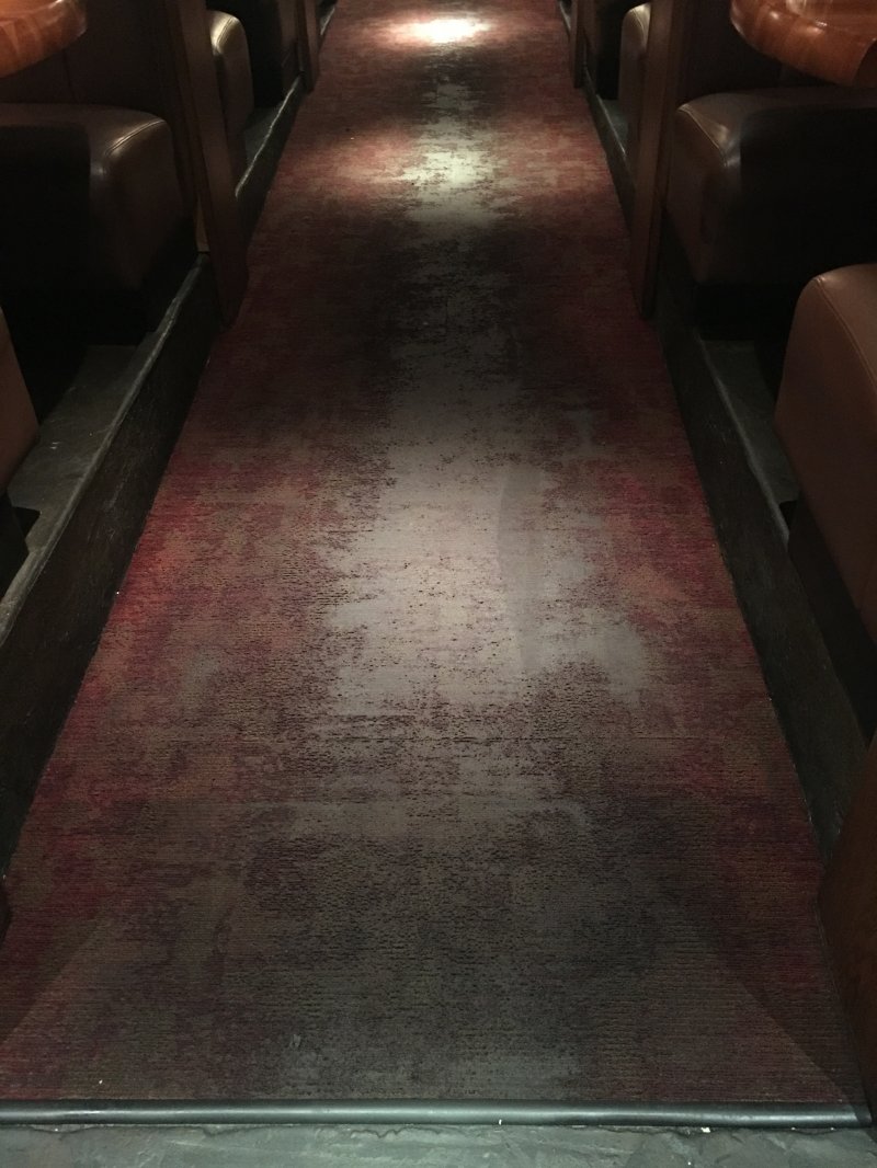

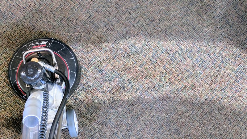

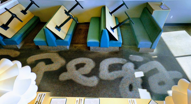

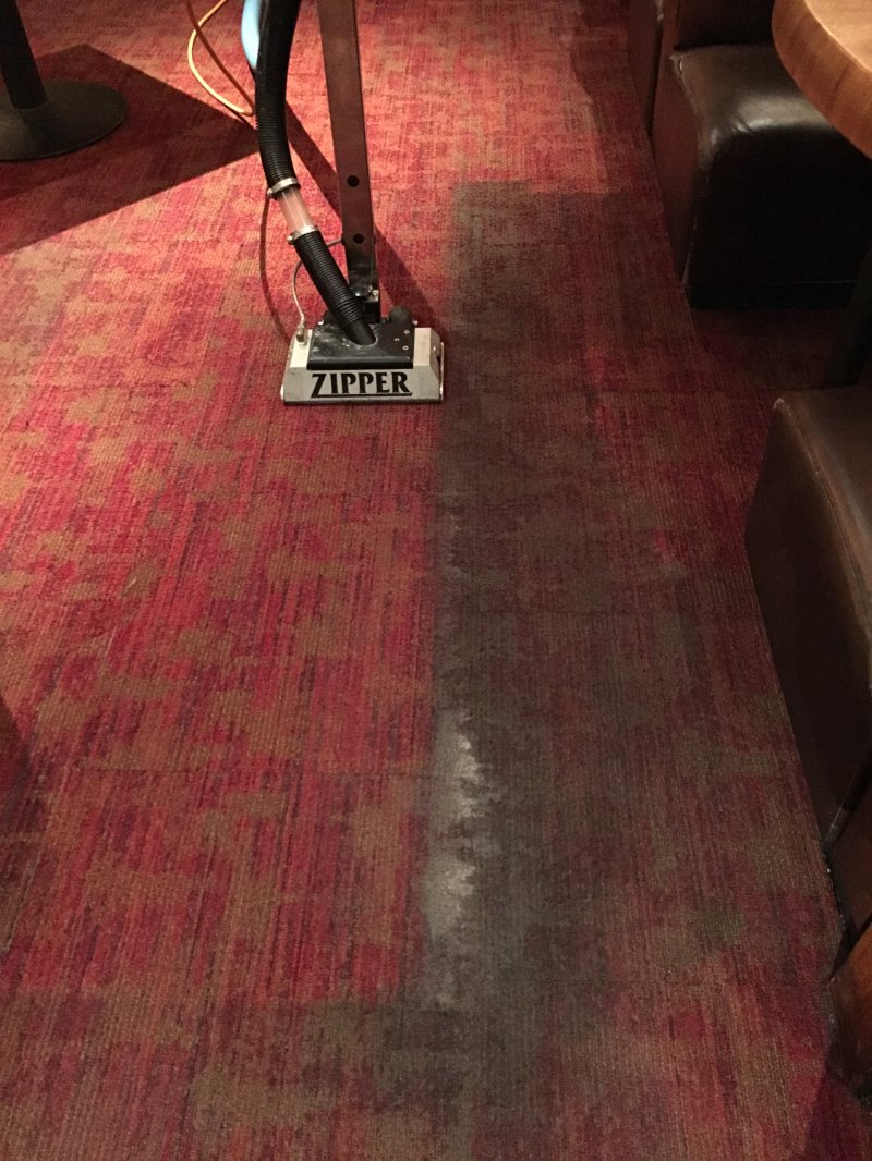

Tried Saigers Red un boosted with a Red Pad/175 and a Zipper with very splotchy results. Maybe I didn't put enough pre spray down, maybe the 370 won't get hot enough for Zipper magic or maybe the Red was too worn...
But lucky we had the 360i to save the day.

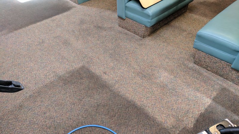

For the second section we added Chemspec BioSolve to Saiger Green and then the magic really happened...
New guy Derrick along ride..

Shower feed or injection sprayer?
We had a restaurant we did that the guys used the Hydroforce and Cimex to agitate. They complainted to me it was too slow and was splotchy.
I told them they only half listened because I told them to shower feed it. The next time they did and the Zipper cut right through it.

I can't believe how dirty that got in just a few months!
I'll concur on that... Shower feeding it saves time and kills 2 birds with 1 stone... But some places don't let us use a rotary so we'll spray and crb it...

I have a bar job... Same look after 3 months on new carpet...
But nice job on the results you guys!
