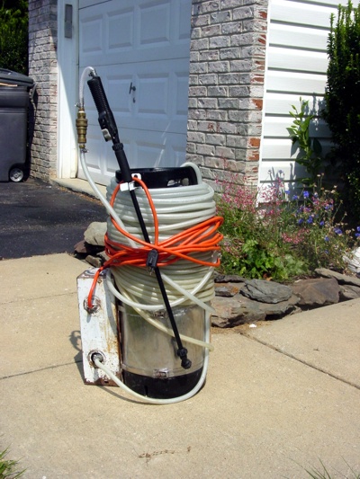

Wayne Miller said:
Simple, easy, dependable, 100' of hose, off-the-shelf 100 psi on-demand diaphram pump.
Anyone has a link to this spray wand and hose or cobbs setup?
I need it badly for my battery sprayer, would prefer a 50-100 ft of hose though, can cobb supply that too?

Bill,
You can get the wand from cobb about $25. (It really is a nice wand)Then just go to home depot or lowes and get the 1/8 inch hose . I got mine for 50 cent a foot , you can get as much or little hose as you want, Shove it in the hose barb that is attached to the wand and put a hose clamp on it . The hose you have now is prob 1/8 , so you can just cut it were it attaches to the sprayer and shove in a hose connector, then connect your new hose to it. Call me if you need help.

I get these wands from windtrax.com, part no. 22650-PP-406 (not sure what the part no. for the wand is), and the hose from usplastic.com.
