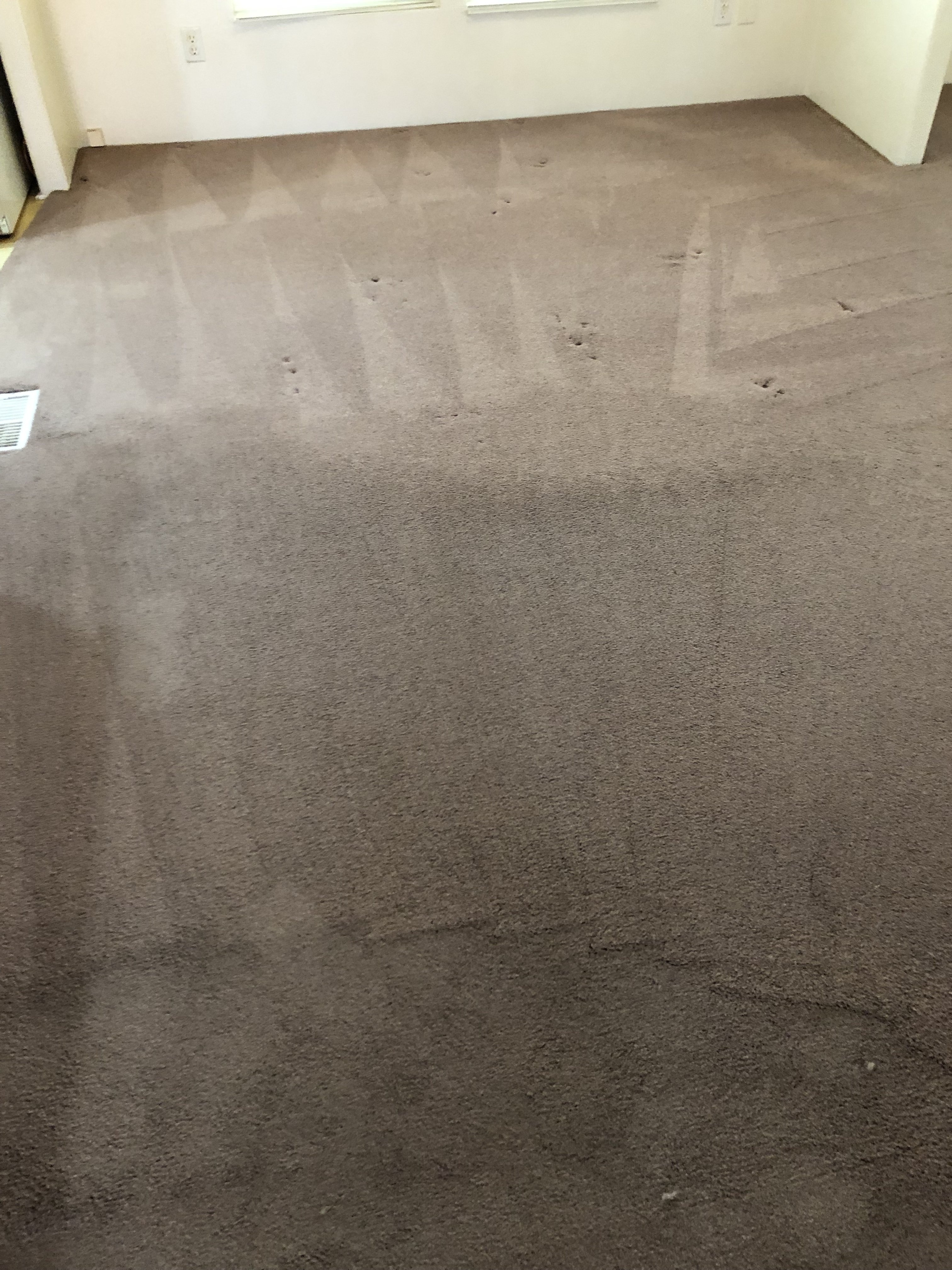

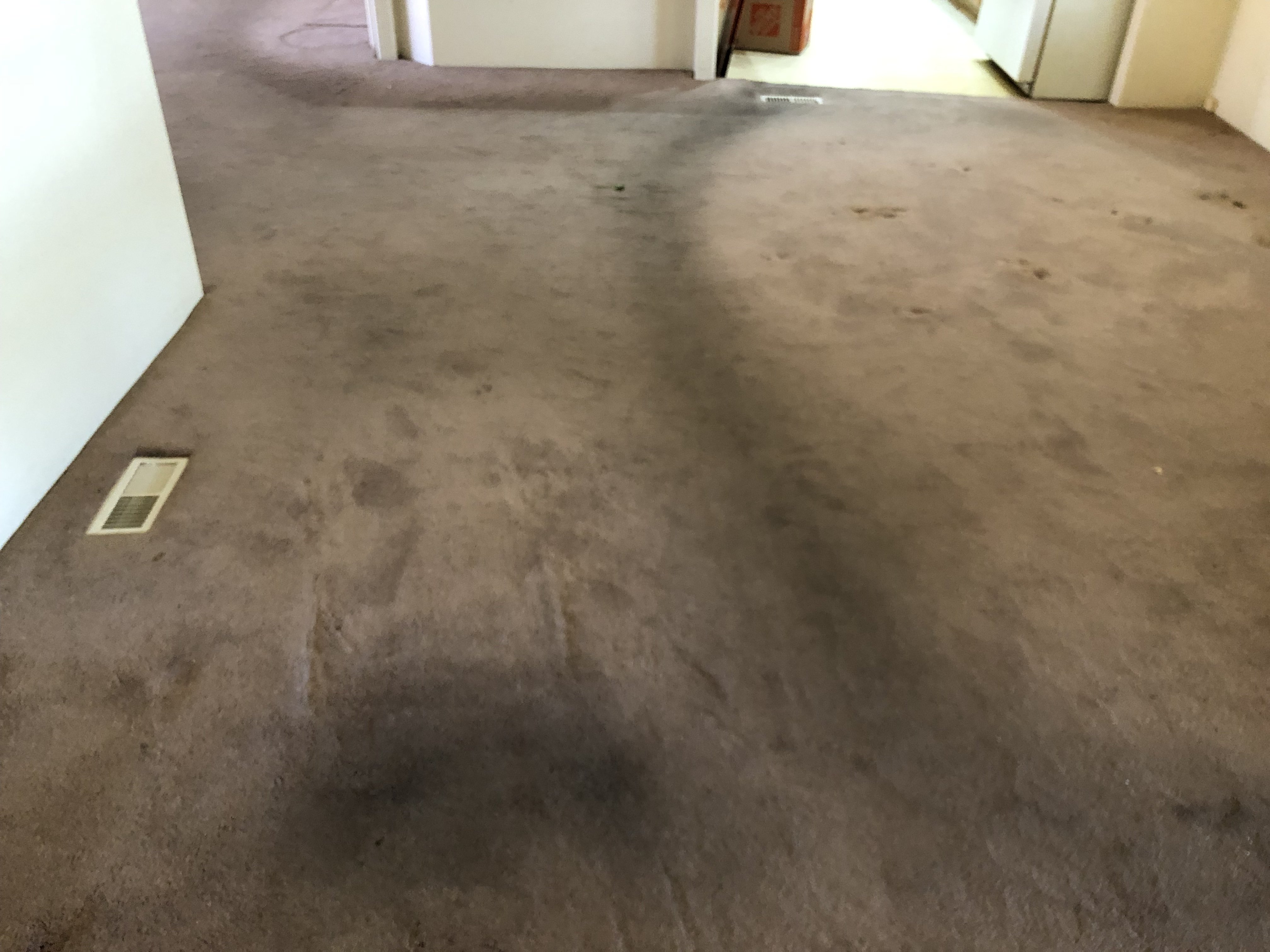

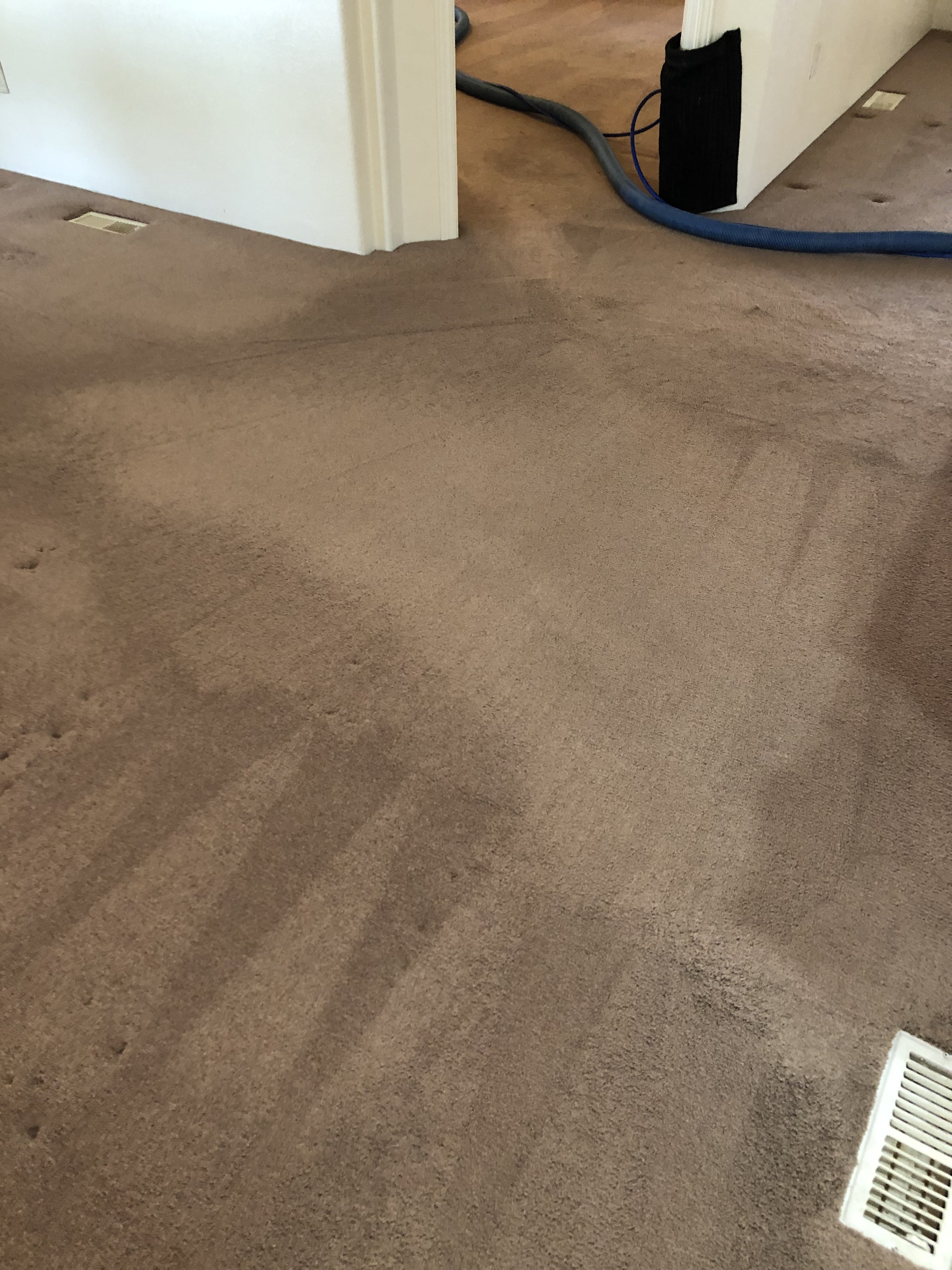

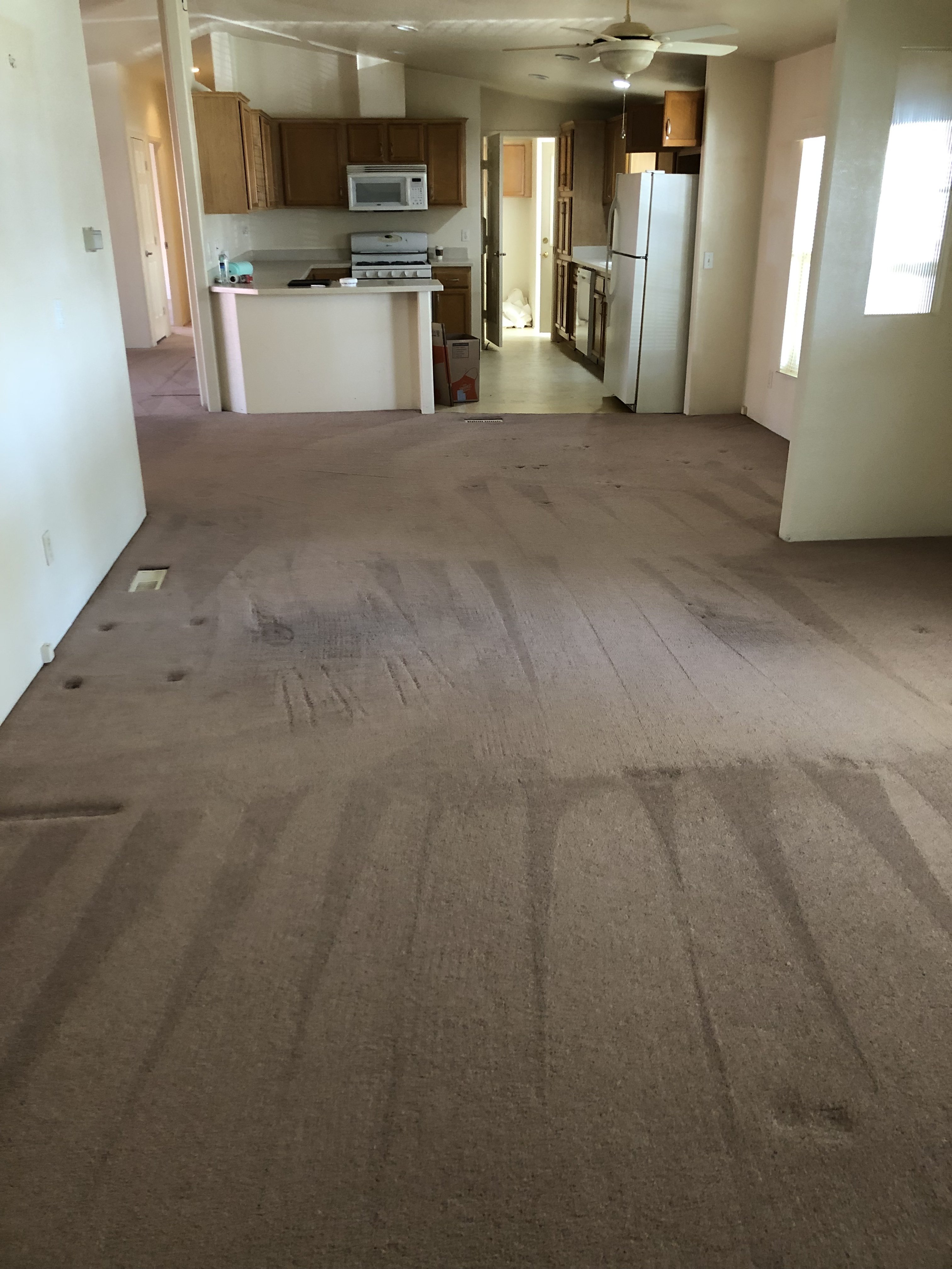

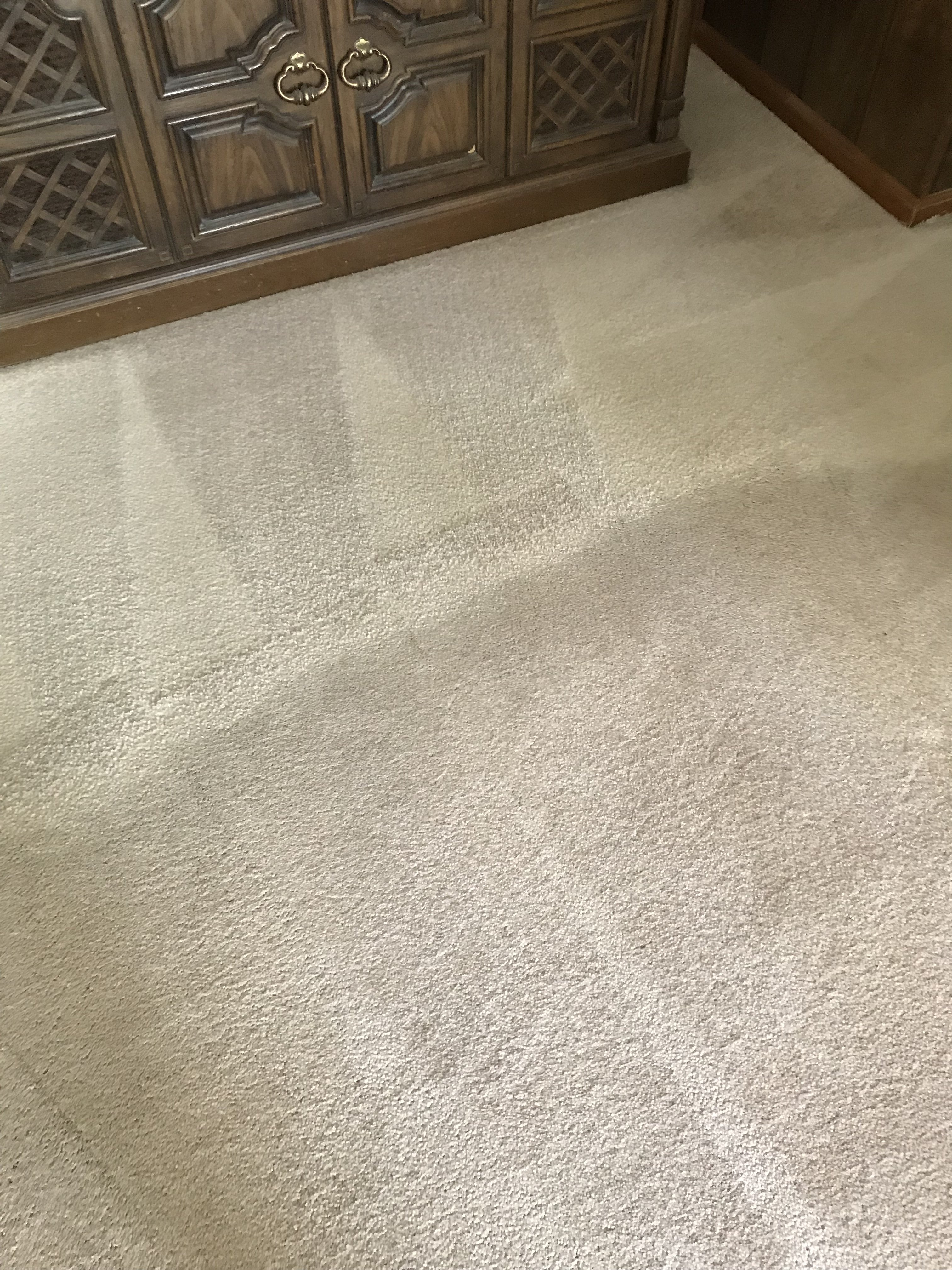

The darker part of the carpet is where the old people do the slipper shuffle. I did not take a before picture. It cleaned up well and they were very happy. I’ve heard about pile reversal but have never seen it. Just wondering if I have finally seen “Bigfoot”? I’ll accept all replies. 😀

More than likely soil and wear.
View the area from opposite sides. As Lee implied, the areas that now look dark will look lighter and the lighter areas will look darker if this is a case of pile reversal. Also see the post on the old pencil and paper trick on another way to check for pile reversal.
The backgammon pattern from your wand strokes is a good example of light and dark appearance due to pile reversal.

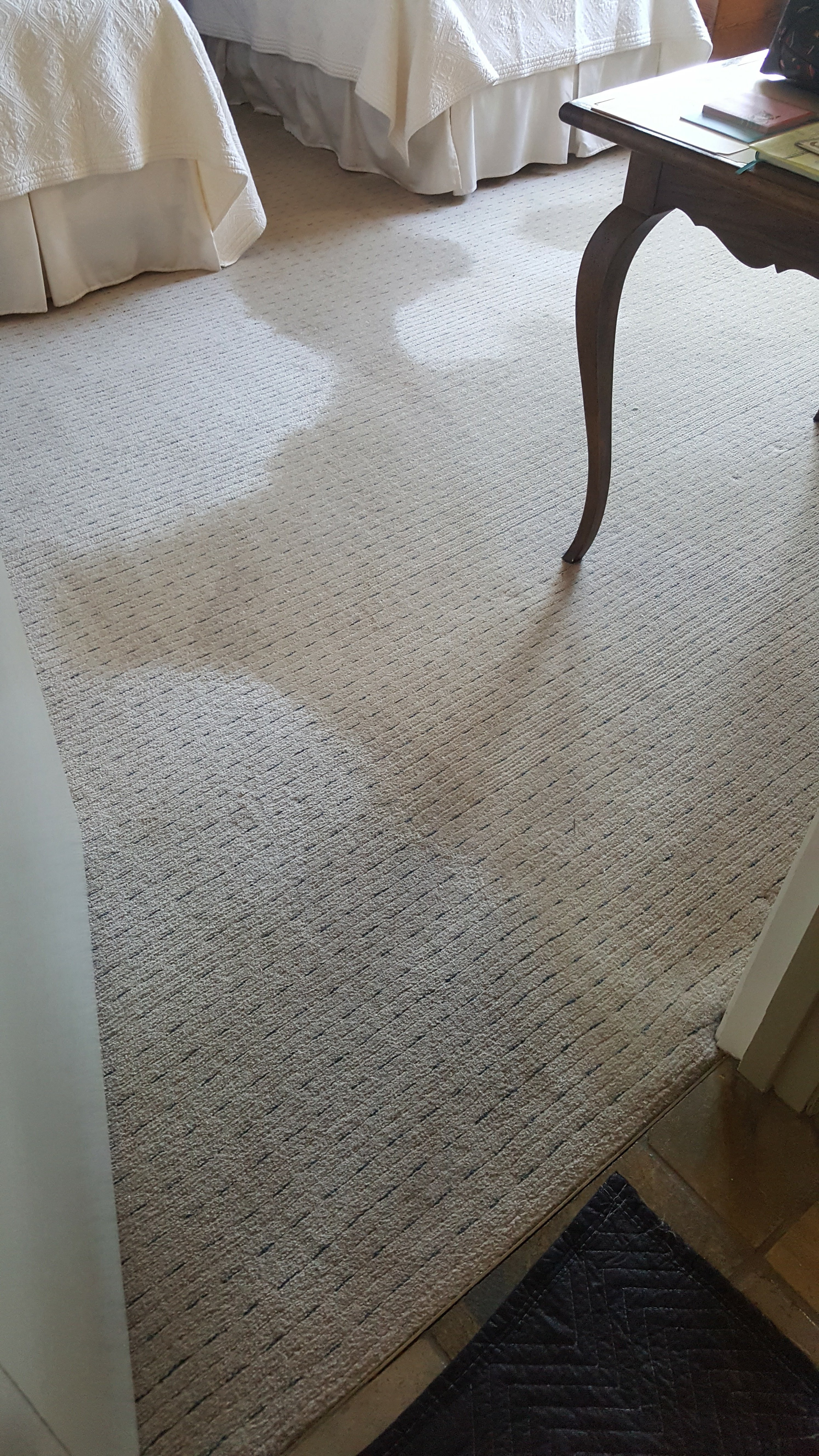

its wear. heres a pile reversal from a regular customer of ours... wall to wall wool, they thought it was dirty traffic lanes. Lucky for me the husband is a scientist so when I googled it and showed him he was fascinated lol

Wool cut pile carpets will do that. I have a building that when it was built, then installed high end, cut pile wool broad loom in all the suites. Before anyone ever lived in them, they had pooling and water marking all over. (Water marking doesn't involve water). Happens to most staple fibers. They shed like crazy as well.

that one in the pic is wool and in some spots u can push the fibers one way or another and it completely changes. When we serviced their home the first time I thought for sure they had a flood or something

Pooling is the form of pile reversal that looks like pools of water such as in the photo above. You can also find a few dozen photos of pooling from the Portland airport taken by every carpet instructor that spent a few minutes there.

While pooling and shading is predominantly present in wool fibers or even occaisional nylon cutpiles, (we have also seen this already in a few smartstrand dense cutpiles) this is more telltail of an older Polyester Carpet.. specifically the older versions of the PET Polyester. We have seen this countless times.. its not soil or wear but rather develops in higher traffic areas where the constant traffic and pad breakdown form this permanent ridging. Its not correctable.

To be honest first picture looks like the pile has laid down (crushed) because of
foot traffic/wear. You see the glide marks are not uniform across the entire stroke the pile did not bounce or rebound after cleaning. It is sometimes why you'll get chatter even with a glide.
I would bet the fiber in the first photo is not Nylon or Wool.
Wool can have it's pile manipulated.
Another factor is that once this condition has occurred you're wearing the side of the fiber not the face. Therefore it "looks" dirty when in fact it, the area, is just reflecting light differently.
Pile reversal as far as I know is not a wear issue but an install problem that is apparent even before any foot traffic. It's the same reason you're supposed to side match wallpaper too.
