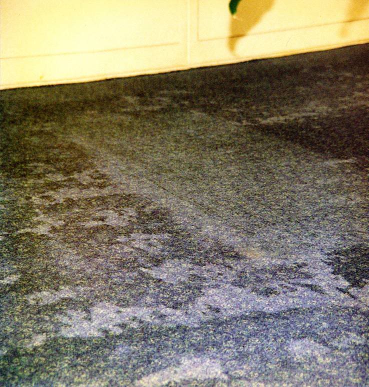

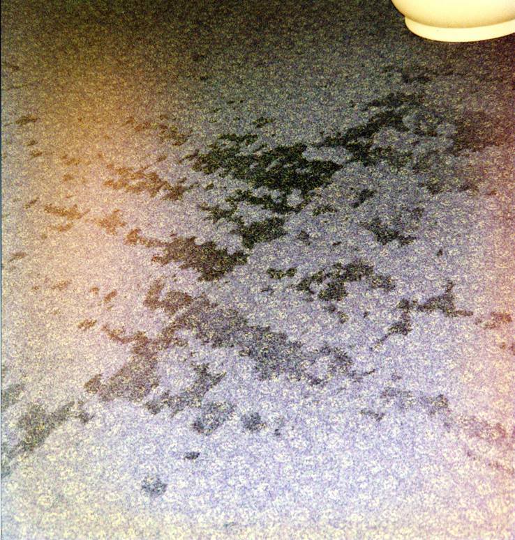

I can't remember where I aw this photo, who posted it or what board it was on but is a classic example of it.
Carpets that are prone to it (usually the higher the density and quality seems the more likely it is to happen, will often now have a clause on the rear of the sample warning of the 'naturally occurring phononemen'. I have seen it on the back of a couple of sample here in NZ and they are not usually replaced as faults.

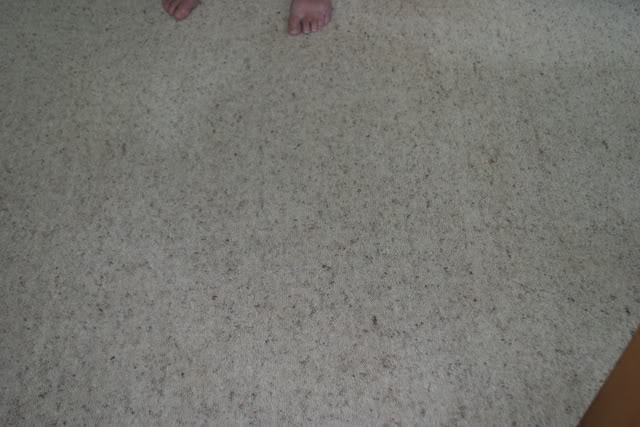

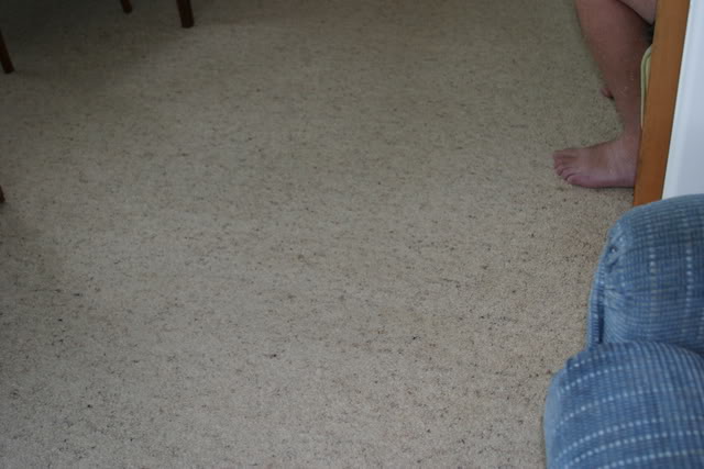

Here's a job I was called into. It was a approx 5 year old wool carpet that had been spot cleaned following an accident. Took a while to dry and recleaned but the 'stain' remained. But only visible from one angle.
These homeowners claimed for replacement carpet.
Problem area viewed from the side.
Viewed from the lounge room.
Viewed from the Kicten side of the dining room.
