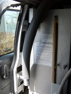

The 2.5 hose is BULKY... Cut 6ft off 2.5 hose ....& run it from the waste tank ....along
the floor..... beside the hose reel....out the side door....then hook to remaining 44 ft..
This is a much easier SET-UP...Rather than wrestling with the entire 50ft out of the
back door. Wrap the 44ft section up...bungee strap & hang on the LARGE hose hooks
provided on the fresh water tank.....

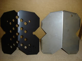

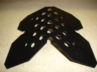

It's great that Joe brought up the vacuum delay pods on the Butler.
No Butler will "fire up" with a high flow 2.5 package, you will always have to cup the hose, and in fact you may Lose mach I setting, where you will have to engage mach II to get it to fire up (I'm not 100% sure as to the tech reason why) but i know it for a fact can happen because of the No resistance issue, it's really no big deal, cause high performance guys are usually always running in the higher speed anyways, if not for heat, then additional vacuum.

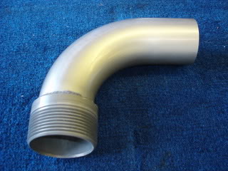

On the topic of Butler PRE-filter Box, here is a modification that is cheap and easy, just replace your stock bottom plate IN the box with the one I made, big difference in vac.
Then you can start addressing replacing your Gray plastic Spears fittings with thin walled gentle bend ones like the ones I make.
If you prefer to hook up out the back door, or have somehow moved your filterbox to the center so you can use it out the side door, then replace the spears 2.5' straight barb with a threaded 2.5 elbow, much easier to work with, and the Thin wall is better for airflow.

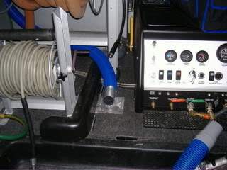

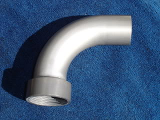

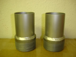

Now, I'm a big proponent of replacing 2.5 plastic with 2.5 metal, but on all of your (5.8 package) butlers 4007 blower, they will have 3" plastic elbows on the waste tank, on vac reel side it will have a plastic bushing bringing it down to 2.5" plastic barb, I don't have a problem with teh 3" elbow it's self, or the bushing, it's the actual 2.5 barb you gotta pitch, either repalce it with my threaded male elbow above, or one of these, much better for reducing restriction:
I probably should have mentioned this earlier, but this all ASSUMES you are off the "live" vac hose reel, and either running 2.5 to a filter box and then out to the wand, or 2.5 from tank to the door and then to the wand/2" lead hose.
If you are STILL on the live vac reel, that is 1/2 of your vacuum problem.
If you Skip the filter box, tehn jsut get one of these, and run 8' of 2.5 from tank to side door; and now you have a fixed 2.5 hook up. You can go down behind the reel to the floor, or up and over across the roof to the side door by fresh tank, some have even bolted it to the riser on their solution reel stack.

I elimanated Mach 1 also....un plug vac. hose & stick a Golf tee in it...."it is usless with 2.5"
I run 2.5 from the waste tank.....Like your photo....But..I run a little longer lead hose,so I
can still use the SAFETY PORT that Butler cuts in the side door....I like to LOCK the doors
when I am doing commercial work...or in "BAWBS NEIGHBORHOOD" :wink: :wink: :wink:

NOT worth the hassle of a sheave/pulley change, once you upgrade to 2.5 you will have tons of vacuum...end of story.
From there on out, you'll be identifying everything in your system that is NOT 2.5" , as all teh 2" stuff is now your choke point...ie: Wand.
