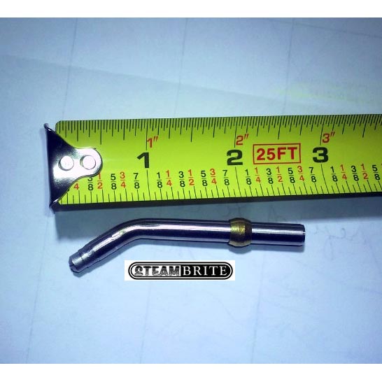

PMF handtool tips, any plugging issues?
115,905
those things, found in PMF internal uph and tile tools, ever plug them?
how did you unplug them?
27,862
I take a strand from my stainless steel carding brush and use it like a tee-jet cleaner, then blow it out with an air compressor. I use a 100 mesh inline filter at the quick connect. Very little problems with clogging.
Reactions: JohnHawkP
14,079
Georgia
If you go through all the trouble to remove that little thing, you might as well put a new one on
Sometimes you can blow it clear with 1500 psi blast
Hold trigger valve open when you engage the pump so don't blowthe 800psi valve
If that doesn't pop it, poke and blow simultaneously
I used craft store beading needles
Theycan be found much thinner than sewing needles
Poke n blow
If it clogs again shortly, pull the jet and flush the tool
