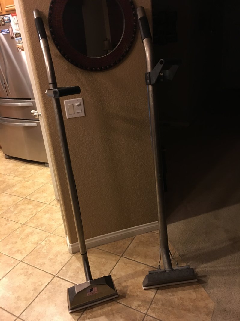

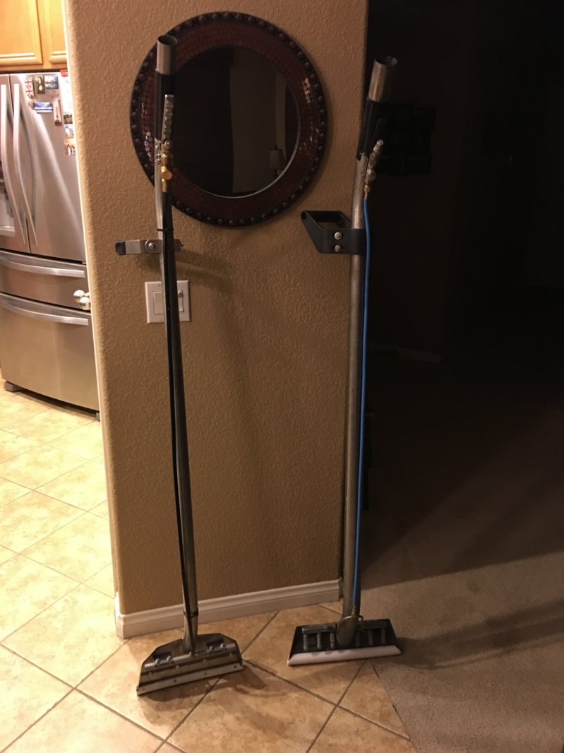

Got the 12 inch PMF wand from Dan, it's long and light like Mike's pocket book.
Seriously jets look to need some adjustment I moved the handle to the correct position. Which is the correct way for me.
Above image is PMF Mach 12 next to a prochem ti.
I wouldn't use the 2 inch adapter either.

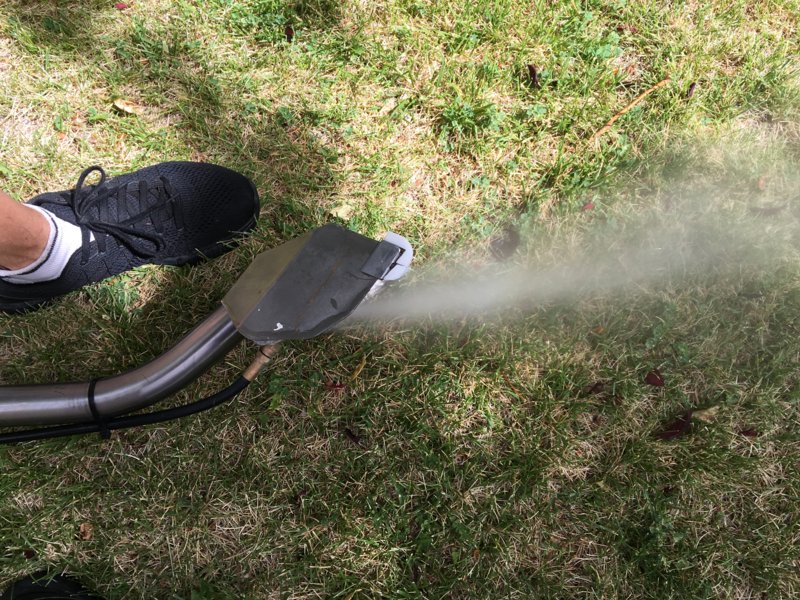

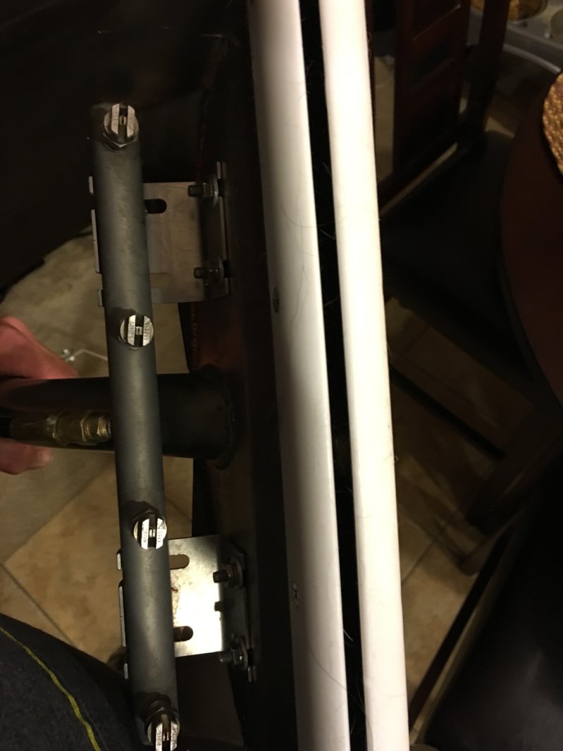

Do the jets look slightly off also not enough sheer from the way it sit now. I'll try it like this then adjust it.
11,495
Hope nobody took advantage and grabbed a new set of stainless jets. :madder::arrrr:

View attachment 14592 View attachment 14593 Got the 12 inch PMF wand from Dan, it's long and light like Mike's pocket book.
Dude, give that prochem ti a freaking bath!

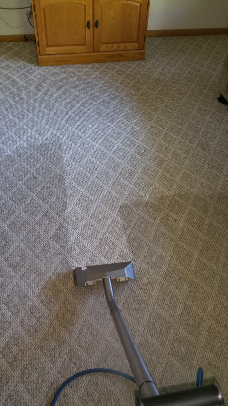

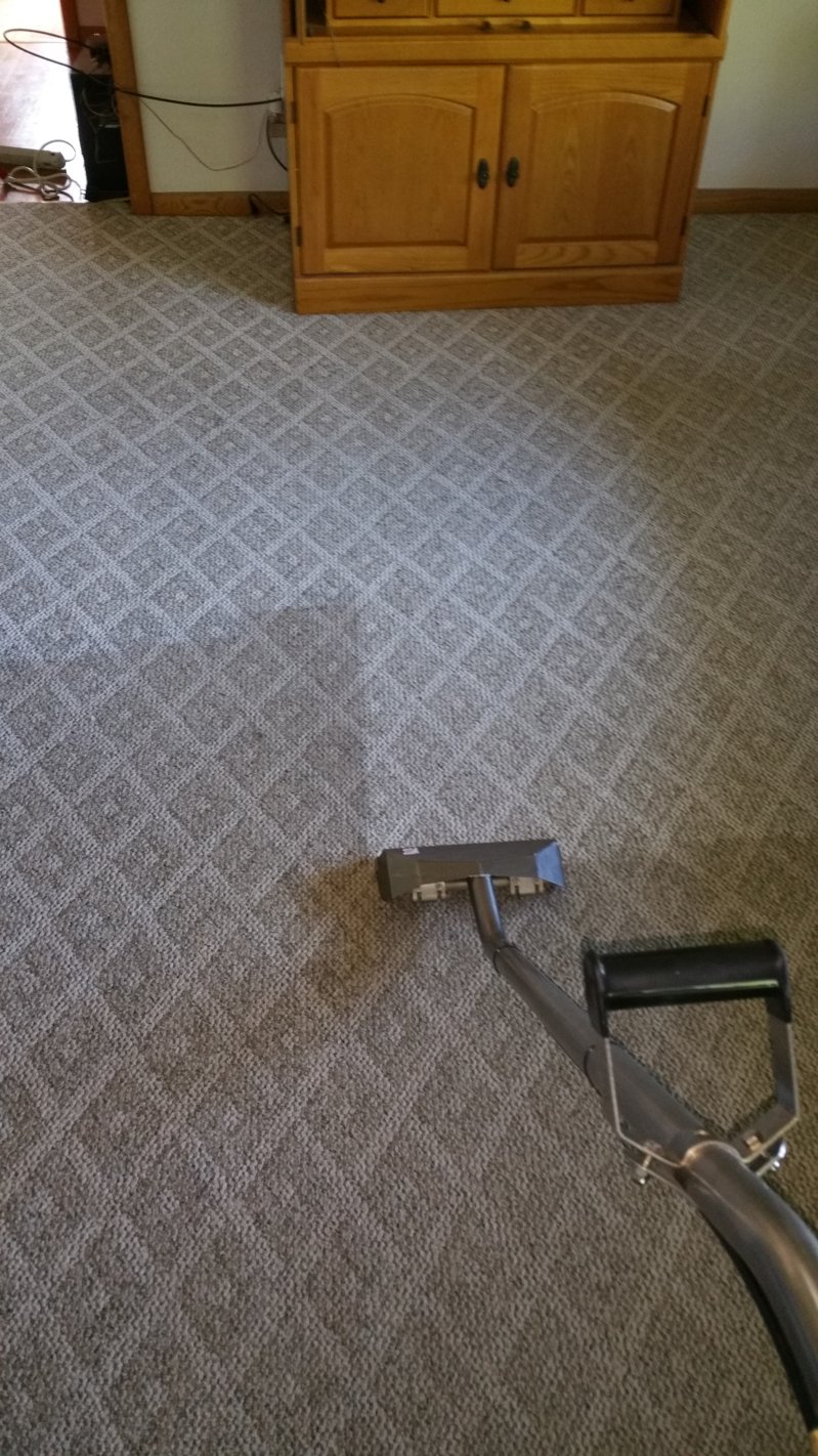

Adjusted the spray And left a room full of sunshine.
