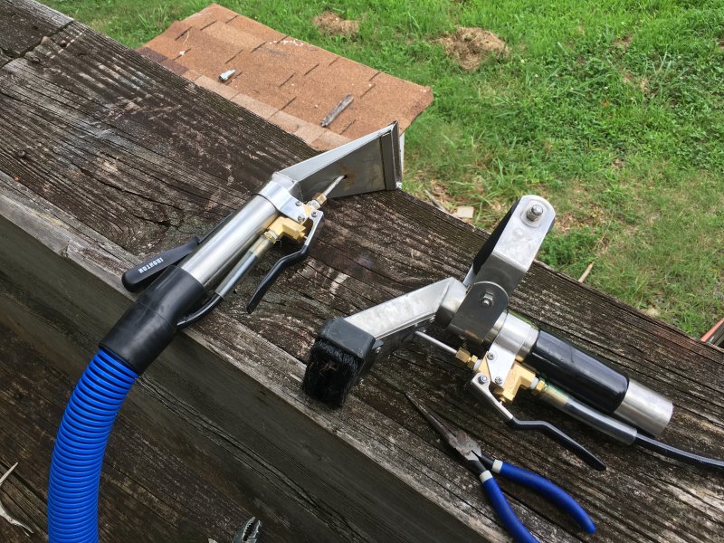

My two ball valves just arrived. Thanks Interlink for the fast shipping
14,544
Not a ball valve
How long did it take you to figure that out?
I was being a bit corny for a bit.
They're the soft touch valves. I look forward to swapping it out on my hand tile tool from pmf and my 3.5" upholstery tool

I did. I'll let u know how it is when I put it on later this week

Who'd you order it from? Lovely Interlink must think that I can magically make mine, because it didn't come with it. So another order from westpak is due. 20-0011part number

Westpak has a bracket on the way to us.
Hopefully I can fit my tool with replacement late next week.
I ordered 20-0011.

It feels good shooting off my two tools
It feels real good at 1000psi. I look forward to cleaning more showers with a decent pressure. I don't know what pmf was thinking putting a 500psi valve on a tile tool
