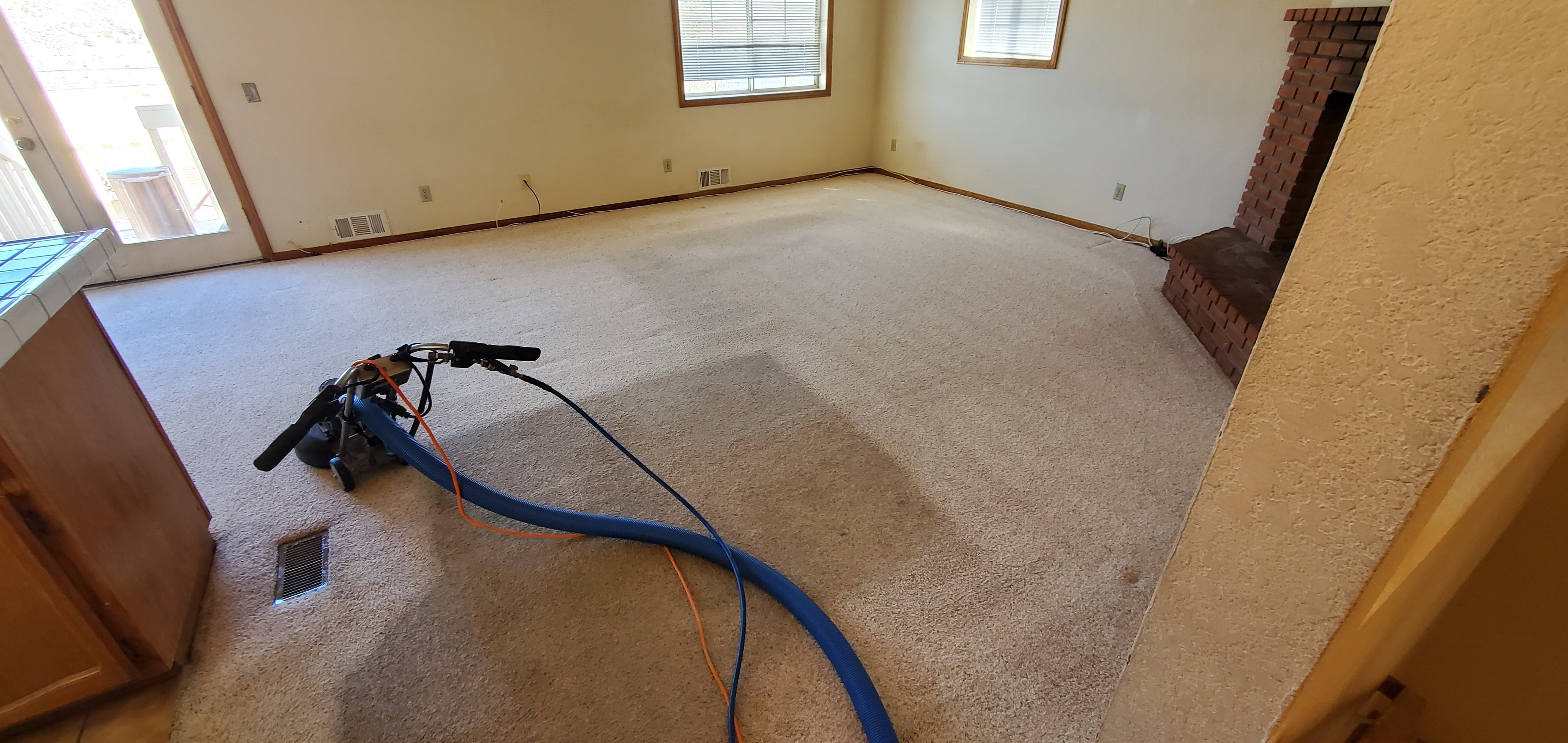

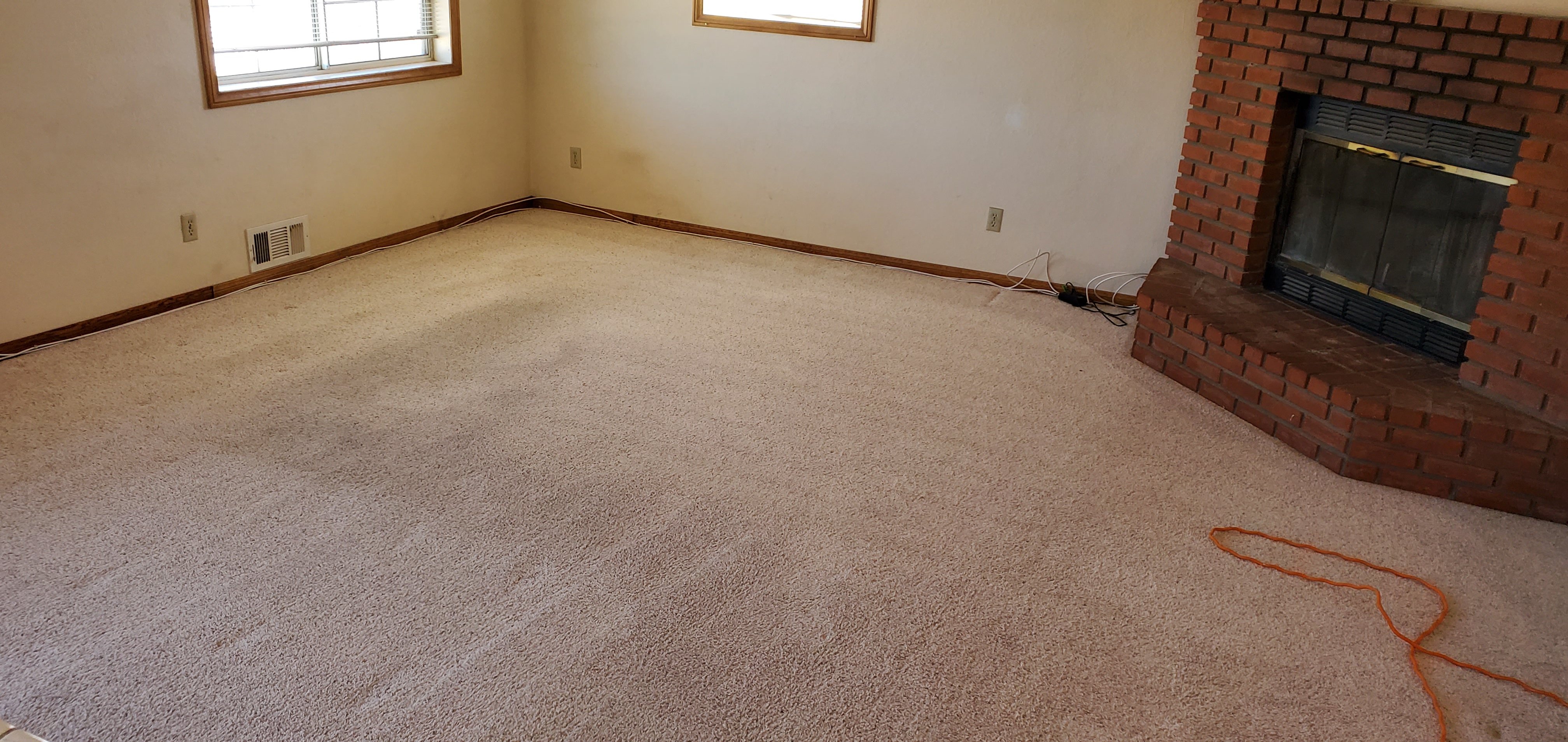

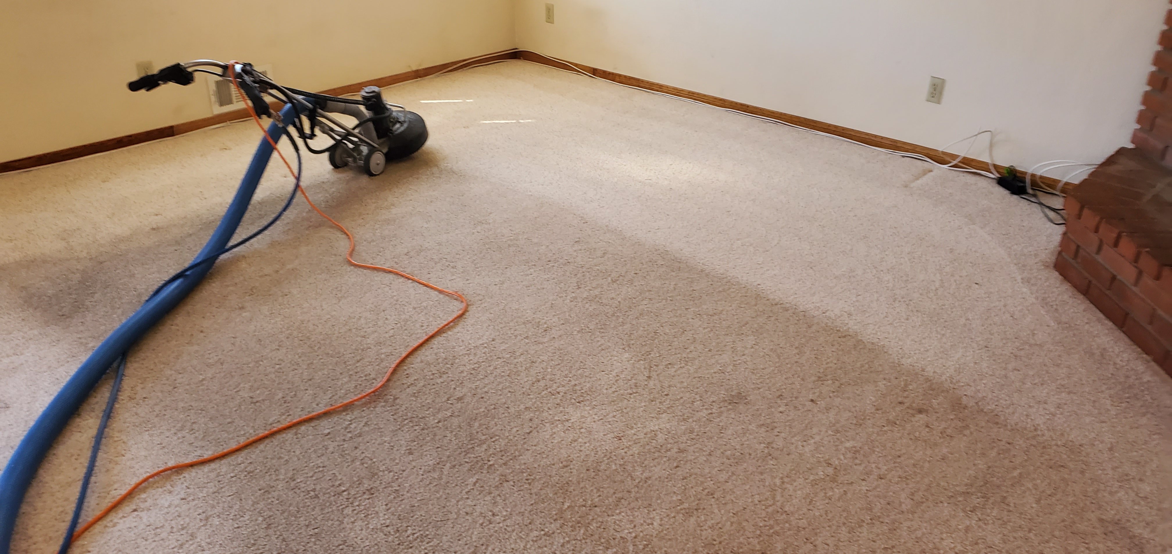

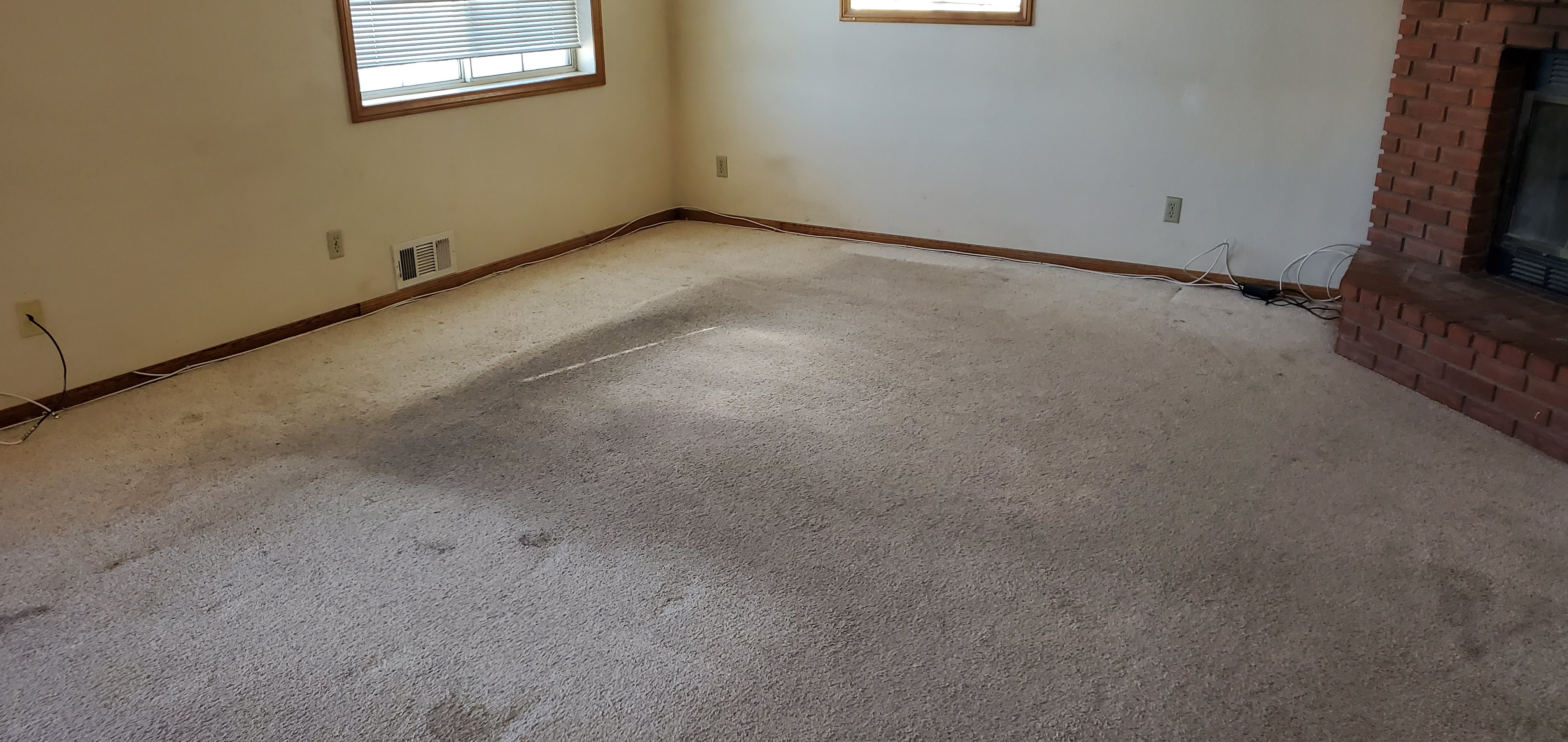

I’ve had polyester carpet give me a hard time in the past, tried to search my thread on here but no go. I cleaned some polyester today, only 3 years old, but had dark path ways in high traffic areas. (I did a acid & burn test and the customer found their paperwork and I was correct that it’s polyester.) I’m using Flex Powder, Rotovac 360i, standard 3 jet head, Apex full throttle and wide open. Sadly it’s better but still dark pathways:icon_rolleyes: Customer is fine with it. I just want better results. Any ideas to get the darkness out? Thanks....

I didn’t take any, it’s not that bad, I’m just wanting a fix more for the next time....
