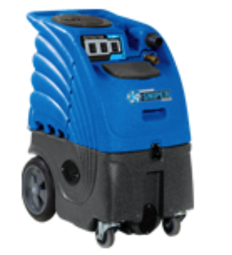

The Sandia 6-Gallon unit would be perfect for what you're describing. Heated, 100 PSI, Single 3-Stage Motor, 1 Cord. Sandia extractors are rock solid dependable. And they're easy to open up and work on if you ever need to service anything.
Let me know if you're interested. I'll be happy to order one in for you at a very good price.
ok tell me what you can do, also what is the weight of the machine
Ok let me know what you can do on this machine, and let me know what the weight is as well
