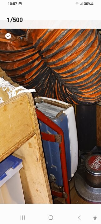

When i ran a portable in the 70's and early 80's i used a poloma6 propane water heater on a hand cart and set it up next to my machine and had it dump into 2- 5 gallon buckets . If your portable has a fill valve possibly you could connect a similar type heater to yours. My poloma would raise water temperature 110° @ ⅔ gallon per minute and would run 20 hours a continuous on a 5 gallon propane tank. I still have the heater on my general cleaning trailer
