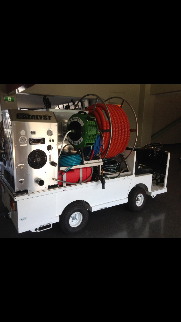

I was also looking into setting up a "townhouse" unit on a utility golf cart or Kawasaki Mule.. A small bare bones TM with propane heater or if a heat exchanger can keep a constant temp without over heating would be cool... Reason for it is I'm not into dragging the portable or running 300+ feet to do a small 3bd, lv, hall... But to make the setup work, we'd need to market and get at least 2-3 jobs in the area to make it worth our time...
Everything you need and drive a golf cart from the parking lot to the door.. Most townhouses maintenance men use them and I doubt they'd squawk about a golf cart on the grass.. When finished, drive in on the back of a full size truck.. I think it'd be cool...

I've thought about it before and I think a cart setup would be best. I was thinking there might be a marketing for selling cleaning carts to property management companies.
I was thinking small TM with submount fresh, pumpout, small reels. It could be pulled by golf cart or ATV which most large properties already have.

The 15 gallon CFX setup on the back of the golf cart would be really simple. You could add a tool box booster and a generator for 4 vac motor power. It would be cool if the motor in the golf cart could be converted to be a generator also. Maybe add the $8k generator Mytee put in their van to run their Escape.
Let us see how complicated and expensively we can do the job.---
A simple CFX or Goliath with a rotary extractor mounted to the back of a cart could do great work.
