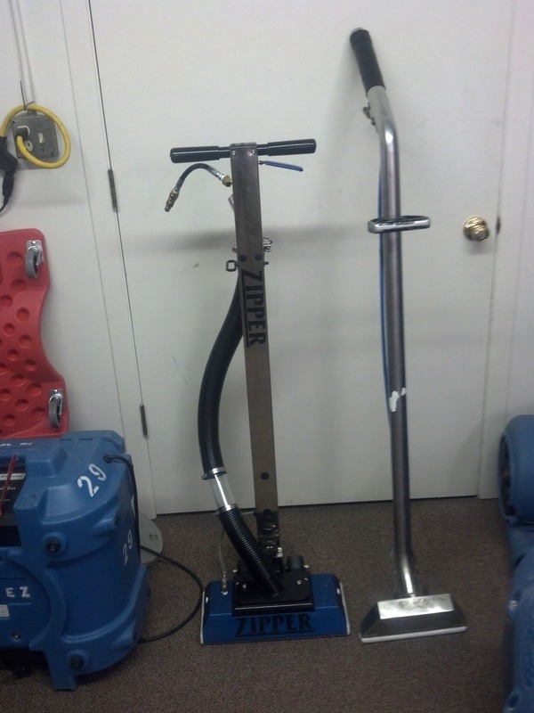

Me too. Because Porkbutt was complaining about the long handle I went and got our regular wand and this is the "reality".
Long handle my ass! :oldrolleyes:
You have to understand to add the length of your arms into the length of the Zipper.
If I have to explain this, then you're too stupid for me to waste my time trying.
OMG you are the dumbest smart man I have ever had the dis-pleasure in knowing! :angry:
Same arms for either tool. :oldrolleyes:

The only negative thing I have to say about the Zipper is that it leaves wand marks/nap reversal in the carpet/rug that will have to be groomed out If you are so inclined. When I use the a regular wand I can limit this trait.. The Positives of the Zipper out weighs the negative.
If you can only handle a 1 1/2 inch wand-- then you are not "man enough" for the Zipper :stir:

Seriously thou Mark what's size zipper in the home do you use 15 inch?
I had a problem with pile distortion what do you do?
or groom.
I just got back from doing two residential the first was an off white frieze that was supposed to be white. I used the Rotovac XL on it it kicked butt. I also used the long handle 2-jet stair tool Olsen sold me. I like that stair tool, its lighter in weight, longer in length and has 2-jets compared to the old Prochem.
Second job was a water loss mostly Berber we used the 15-inch Zipper on it. It worked great, took the water stain out and left it very dry. Love that tool also! :cool:
15 inch Zipper, but I have not seen where the Zipper creates pile distortion really....
I see pile distortion in a lot of carpet, but haven't had an experience where I think the Zipper is causing it.
We run our psi at 500 and also run .02 jets....
I also run our Prochem Titanium's at the same psi and flow (12 flow)
Not sure if that info is helpful.....
