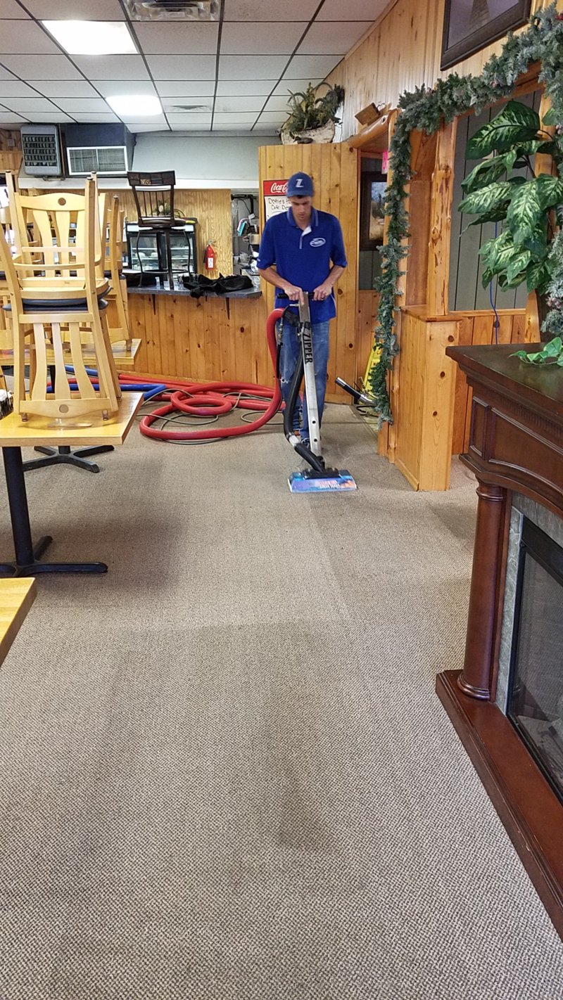

I know Marty is going to love another video....

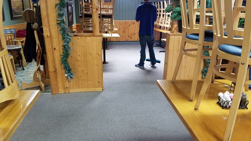

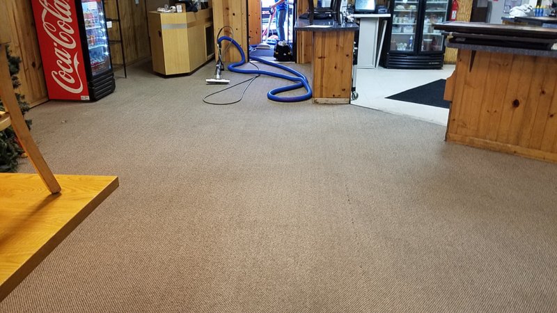

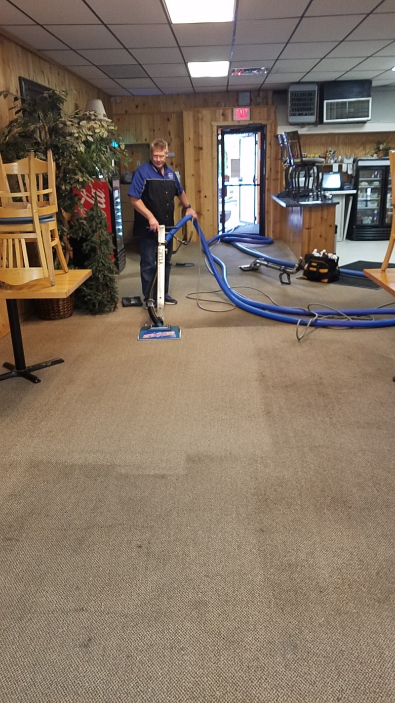

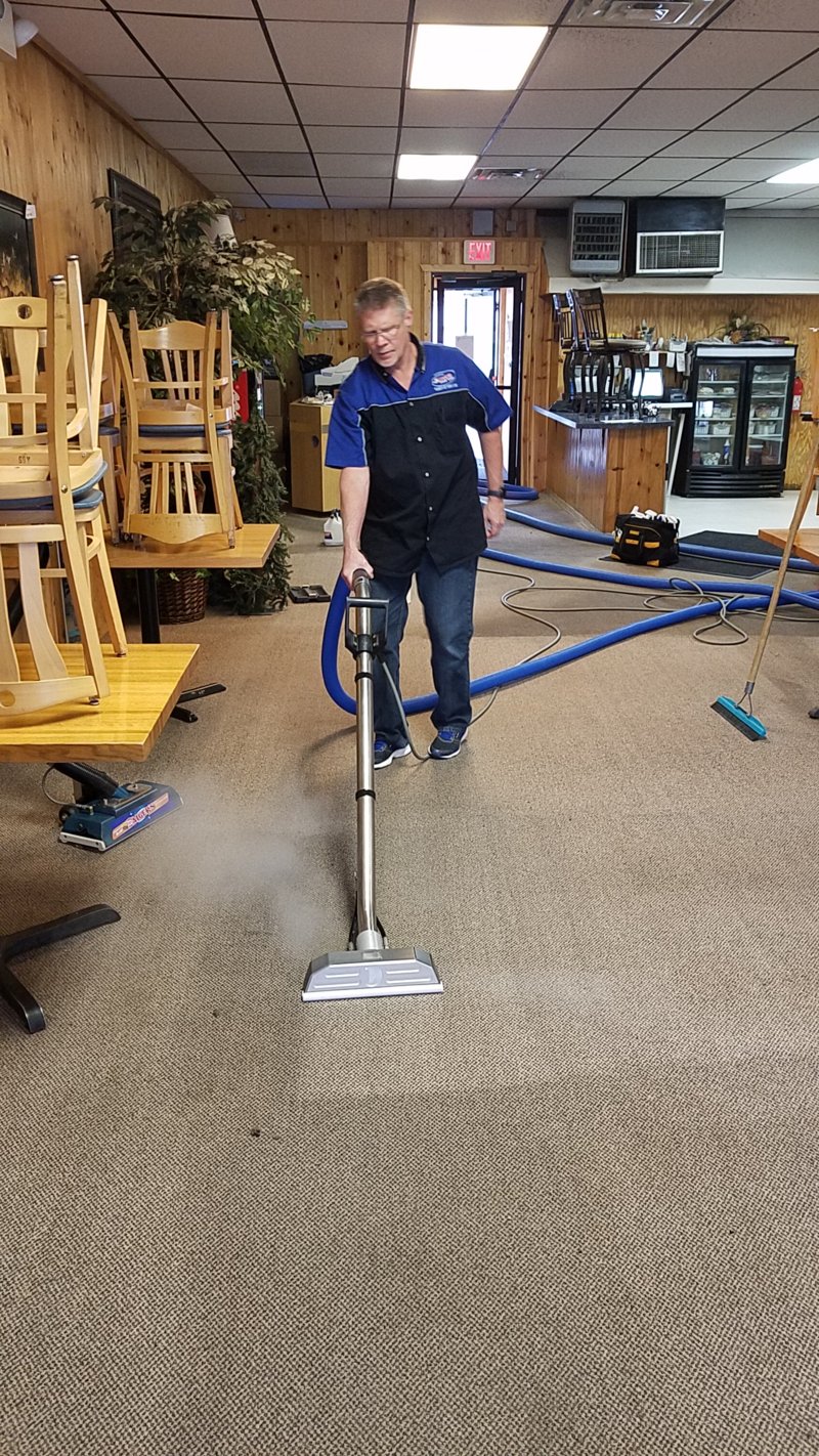

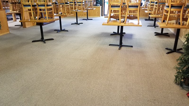

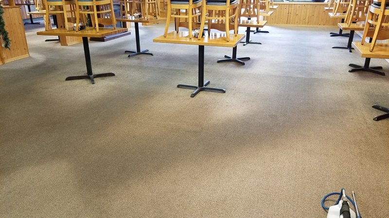

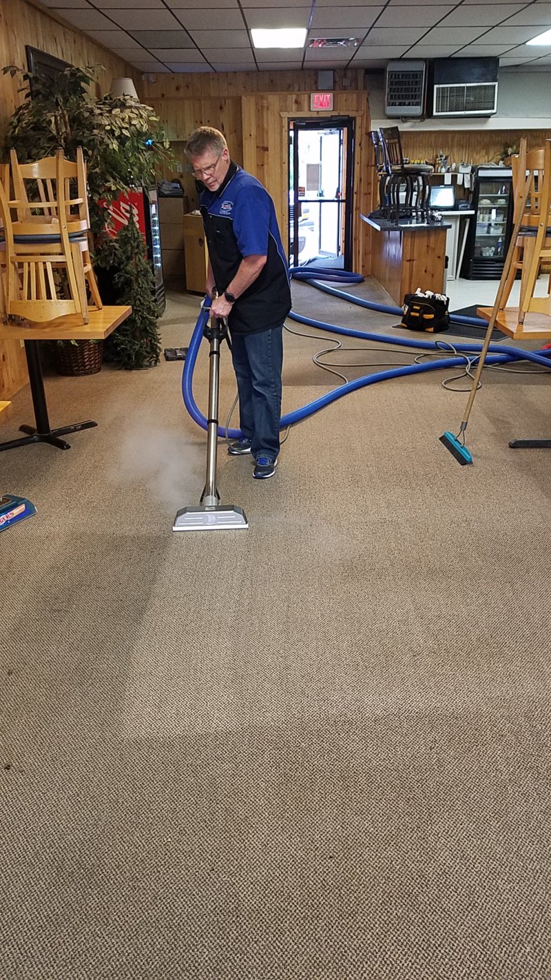

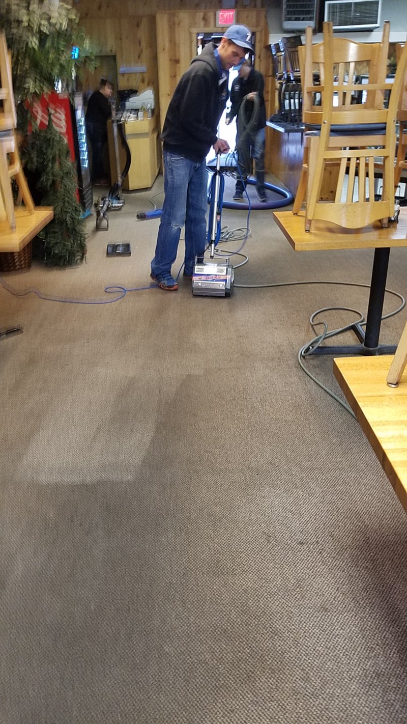

Just moments of where prespray if applied uneven in some places...you will notice (as most of us do know)
And times when an inline sprayer will malfunction....and hopefully notice...but some techs don't notice.
and...how many times can I get something stuck in my Tom Conway wand in one day...had a few moments....
And the colder weather setting in made this one of the toughest floors to clean...humps and bumps everywhere this time!

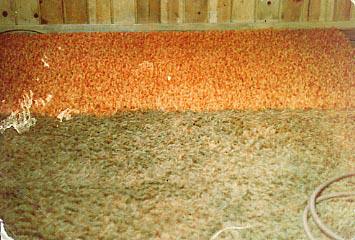

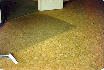

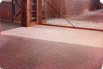

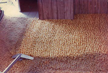

No prespray, just a Steam Way Powermatic, Steam Way wand, and Steam Way Formula A through the truck mount. Back in the 1970's.
The top picture had just been cleaned with a portable steam machine.
That being said, Mr. Saiger is right about pre spraying, especially on those restaurant jobs, particularly olefin.

View attachment 18696 View attachment 18695 View attachment 18693 View attachment 18694 No prespray, just a Steam Way Powermatic, Steam Way wand, and Steam Way Formula A through the truck mount. Back in the 1970's.
those pics don't count. That was with carpet that was made to be cleaned. Today's crap is made to be thrown away.
11,199
Grand Rapids, MN
a 175 (or Cimex :icon_redface:) would make a far better/faster pre scrubber on THAT carpet.
Some one is going to start bringing three vans full of toys to jobs and blow you out of the water Saiger.
or put a pad driver under your RVXL and Red pad it.
Actually had the RV and red pad...nope...this dang floor was a small mine field of mole hills, valleys, crevices, bumps....more bumps.....Ridges...
A cimex maybe with Shampoo brushes might have done the trick....but this floor surprised me this time....
I have been able to Zipper the entire thing in the past...something about the current weather messing with foundations...including my own home....
But....we got it done...and the little 10 inch CRB...hopping...skipping...and buzzing along did the job....(and a wand)
We actually did pretty good time...in and out with the two vans in Two hours...did very well per hour $$$ Too....
But...everyday...a new surprise somewhere...just had to roll with it :)
