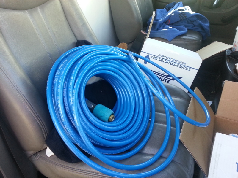

Yes, the first item is the Parker 1035HT with the more-visible safety cover.
The blue wire-braid has been much better than Neptune, in regard to "black death" @ 275° on some fire-breathers.
For high temps, we use the blue wire-braid @ the truck . . . ,
and the easy sliding 1035HT inside the house.
Temps are any water the hose is in contact with.
