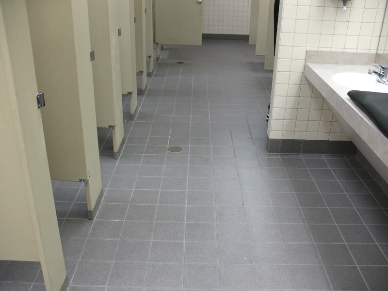

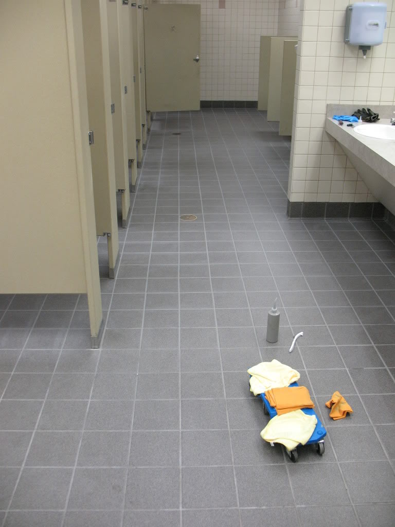

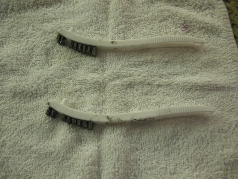

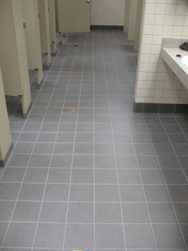

Here are few pics from the job.
About wore the bristles off those brushes!!
