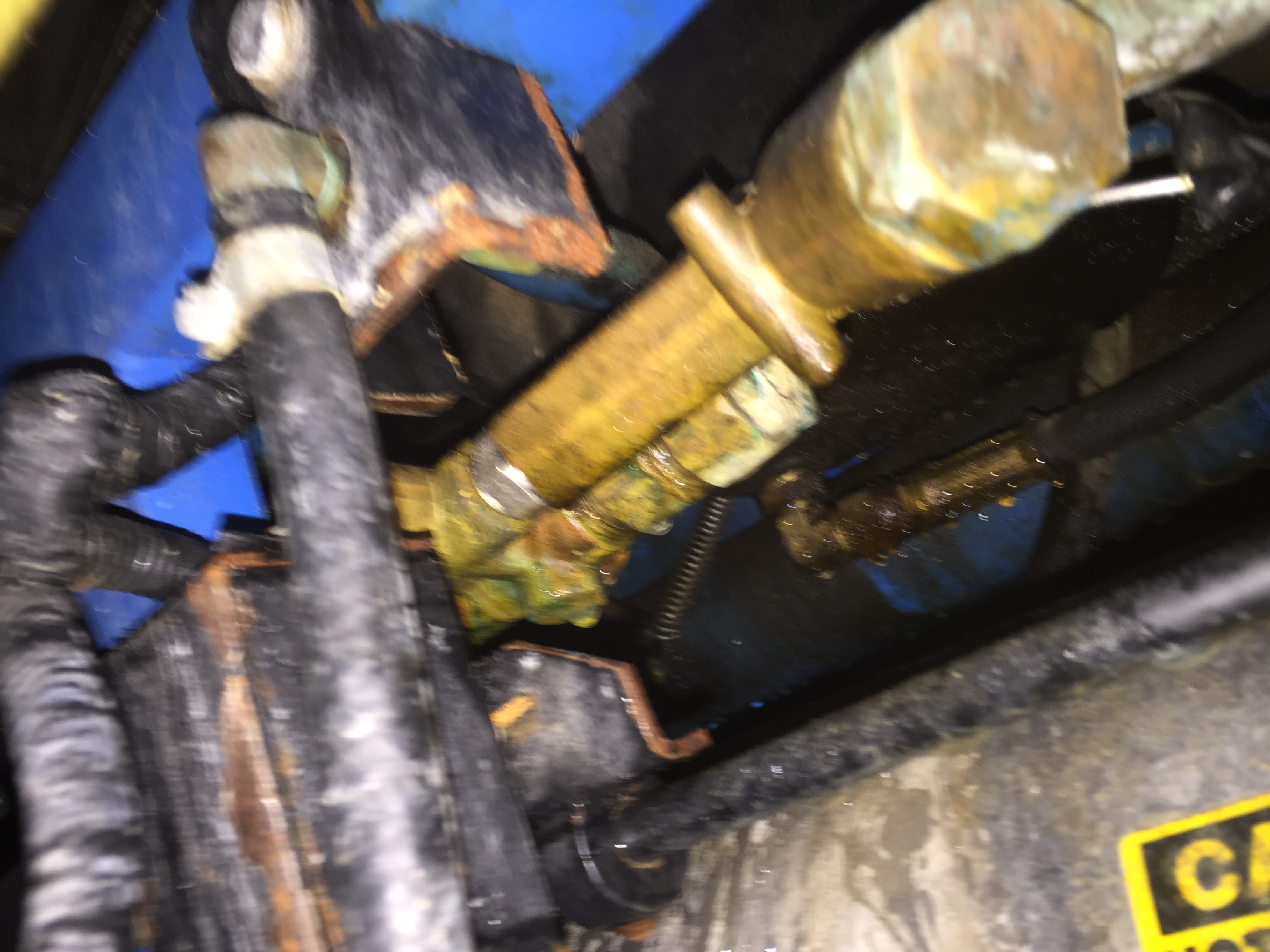

We got a church flood on Friday suck water out of commercial glue down, and empty 400 gal of water outside that a pipe burst filled, the drains didn't work.
So my guys went to spray a disinfectant and had the water off when they hooked it up the water pressure gauge wouldn't go up. I think it got hot from extracting water vapor locked or the pressure gauge is broke my son was inside waiting for my other helper Phil to get the water on.
Phil thought he turned the water pressure down do he starts cranking water pressure up the gauge doesn't move do he keeps cranking.
Finally hears a loud pop and water starts flooding out bottom of machine seams like its from the center of the machine.
My mechanic is gone tell the 12th.
Might have to drive to valley to get it looked at hope it's just a hose!

It's leaking underneath behind heat exchange above black back hose in photo like a water fall can't see actual break

Not your return line from the bypass. Probably just a blown high pressure line. Maybe coming down from the helicoil. Could also be the line to the bypass solenoid.

The path is:
Pump
Regulator
Graham hx
Exhaust hx
Manifold
Hose between each.
You said leaking like a waterfall so I thought not the small lines from solenoid or manual divert valve.
The line I first mentioned empties into the waterbox. It is heater hose and will blow if subjected to full pump pressure.

If you cant find the leak in 5 minutes with a flashlight, you probably should go to a mechanic.
11,491
I think it's the helicoil line because it runs right through were the flood is coming from
11,491
The water is pouring out behind oil drain line on oil pan in middle of machine
If its the one from the Heli coil to the Heat Exchanger the part number is 10-805375 hose,HP 3/8 x 26

I dont know they fixed hose replaced a coolant hose that was olld and charged me $275 with a few brass fittings.
