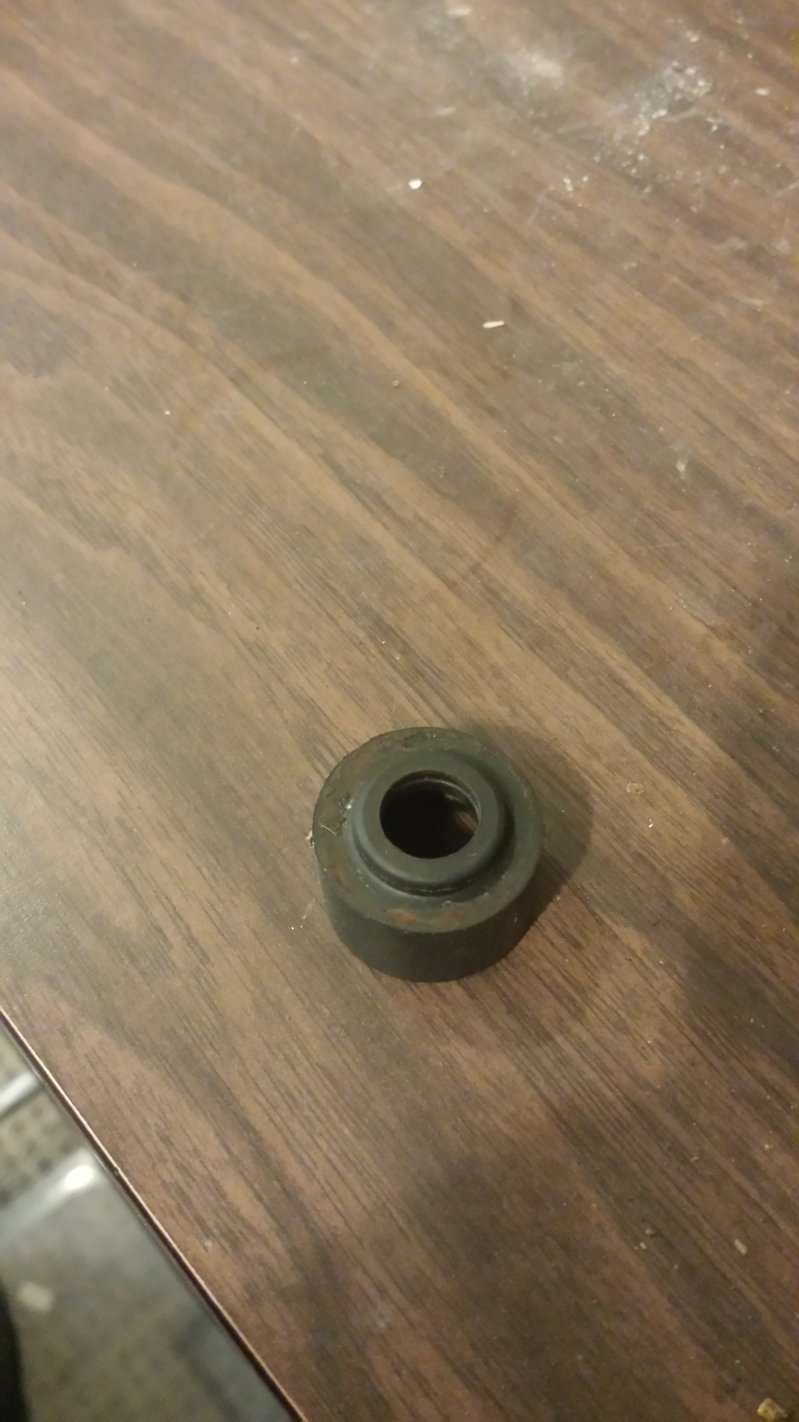

are we talking the boots here?
air get trapped...heats up....pops off
lot of boots have a hole to let air escape
/sorry...didn't want to read whole thread
Reactions: Able 1
dgardner
Apr 7, 2008
5,109
Dan Gardner
Good idea. Something else to check. So, if you pop 'em back on while hot it lets the pressure escape and solves the problem?

Able 1
Apr 12, 2008
6,469
Keith
They are hard boots, but they have this seal around them.. they are air tight, you're probably right Fred..
