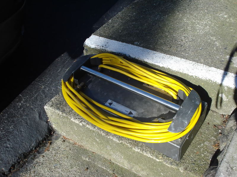

Unless it's a 2 plug heater, I'm highly skeptical. I have this old Kleenrite 2 plug, and while it gives me a big burst of heat and holds it for a while, it still requires some adaptation in cleaning technique.

Willy P pretty sure its a single im on 240 v 15 amp . is your kleenrite a 120 v??
e
2 plugs,both 120, one dedicated 15 amp for 2000 watt and a secondary 1500. Hot enough to burn if you aren't careful. I use a 500 PSI Cross American Recoil with 3 vacs. Hunting out 4 seperate circuits can be challenging at times, but when it's rockin' it a great little system. I service mostly high rise accounts.
