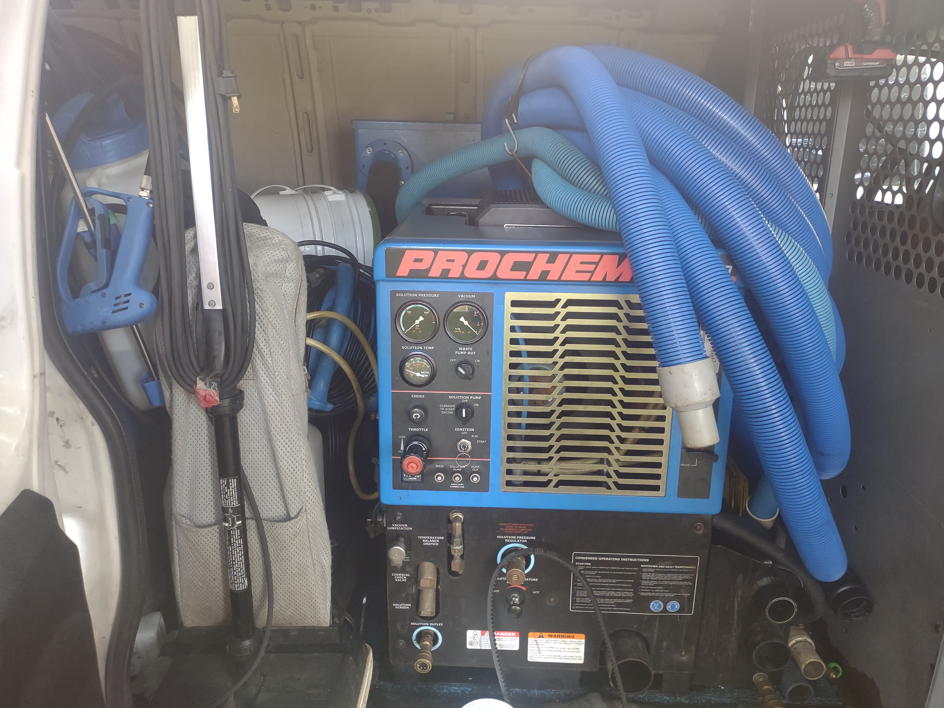

Check the Lint trap and blower filter.
Check and change the blower oil.
Clean the "blower relief bolt"-- these are the bolt you remove to fill the oil and has a little hole in them.
Organize the van better--
Maybe the hoses are dripping water onto the belts and pulleys.
Wires and hoses can also be accidentally disconnected when cluttered like that, and this lowers your curb appeal.
