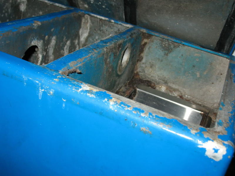

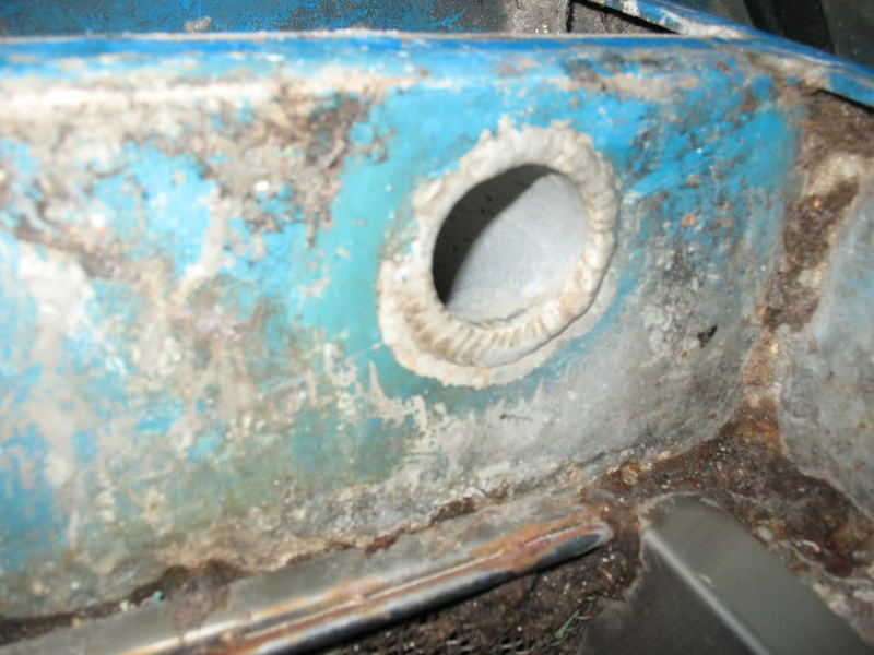

Bypass valve to the water box plugged, shoot, what's the name a that thing, sorry been four years since i had mine. That will make it do some odd sheet, check it out, located on the right side, under a one inch plug, use an allen wrench to get it out, start the machine up for a sec to blow the gunk out, and blow through the tiny bypass, and look to be sure it's clear before replacing.
maybe.
boazcan
Jan 11, 2007
1,522
Tampa Bay/Central Florida
Bryan C
How do I cap this hole off ?
