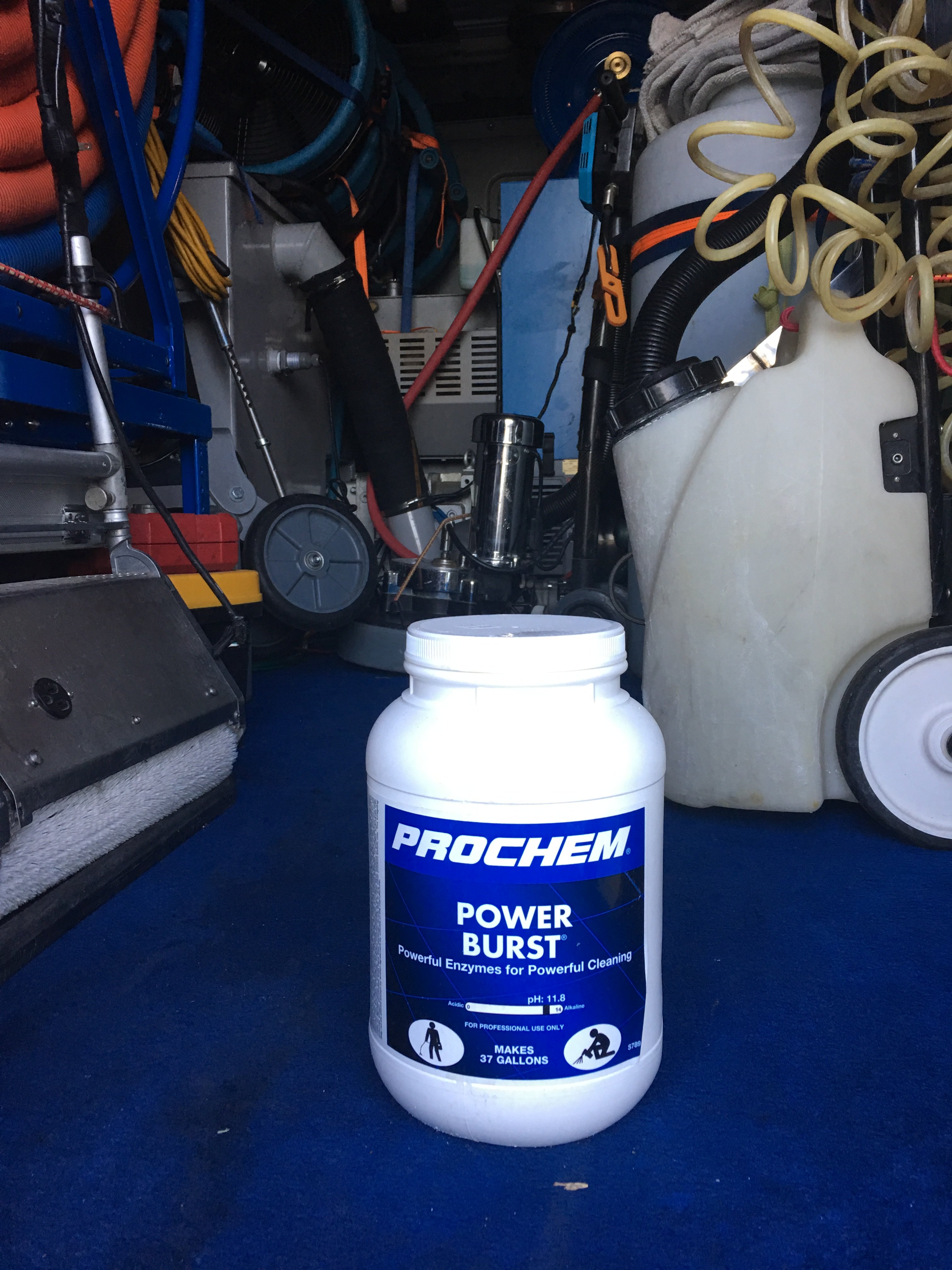

Anyone use this stuff? I’ve got a case in my garage and today is the day I’m using it. Anyone got any feedback?
