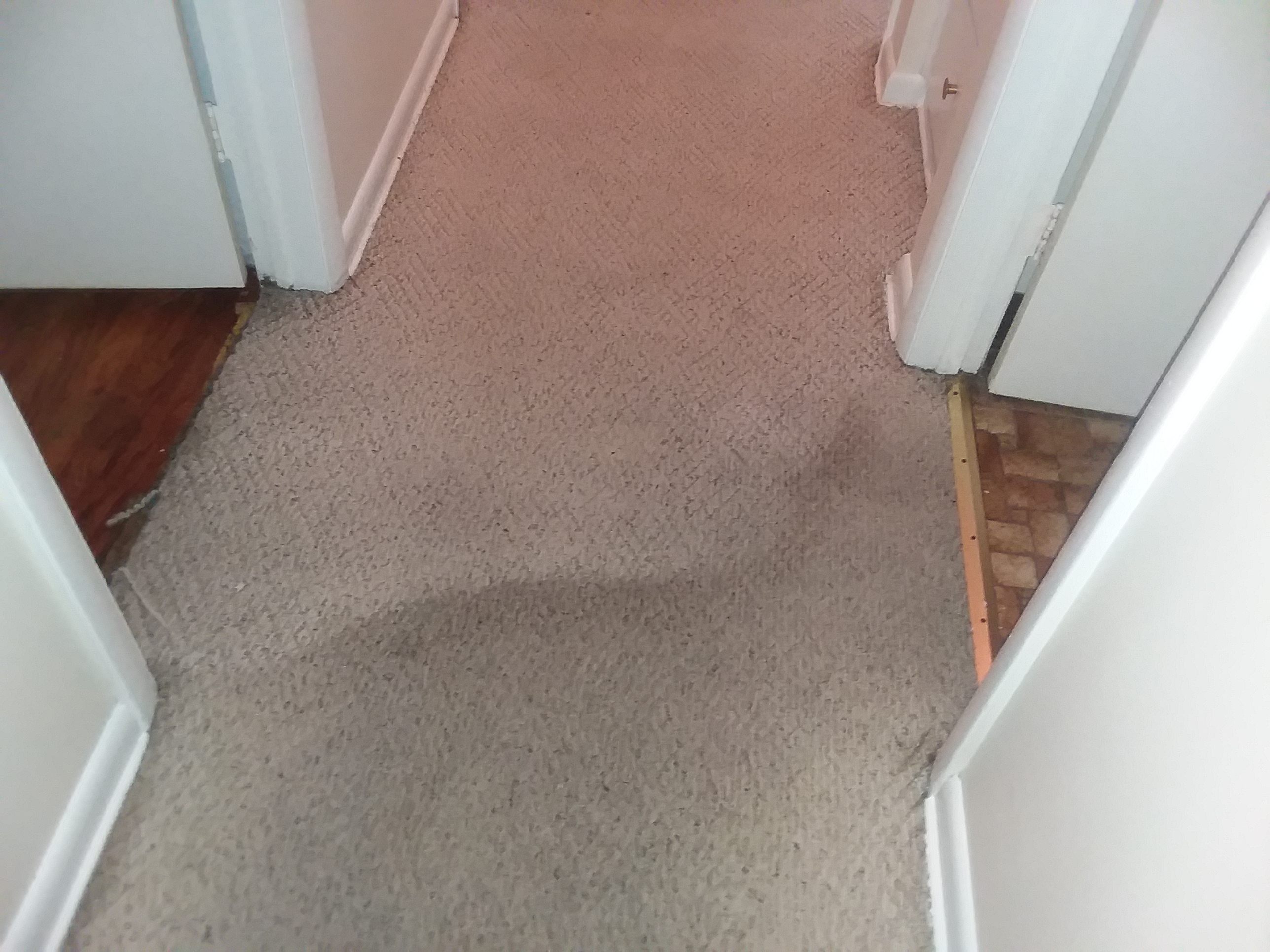

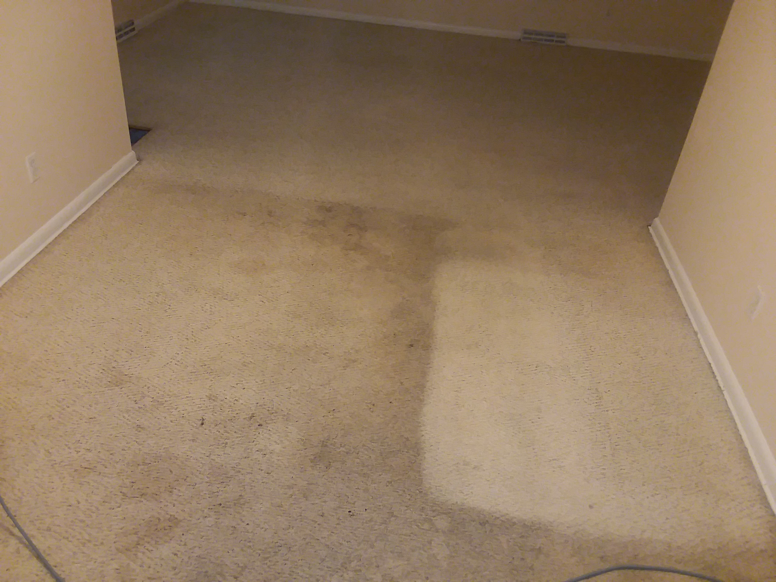

Used it again. I will admit, I was tempted to scrub and run. !! Absolutely trashed olefin berber.
Scrubbed with 175, mixed stronger than directed. Because I wanted to make it foam up and stay in the fibers. Was also temped to boost with something /anything as we carpet cleaners are wont to do!! ( But I did not)
Pics are of scrubbing, tank shower feed through a green pad.
Besides, it smelled sooo good. hated to flush it away!!
Rinsed with an encap product. Pics are of scub only, before rinsing.
The jar I bought, not a FREEBIE!!!! :winky::winky:
Also, just recently figured out how to post a picture. ( I am old and never make myself look into it!)
View attachment 86042View attachment 86043
I went back to be sure it dried OK. It did.
Also , to be sure I could justify the high price I charged.
As this is a PM company, who manages for many, . I rarely get feedback.
With these type, tho only feedback usually is no calls for more work.
Also, you never get a straight story from them.
Do not want to push it too much.
As I said , first 175, then flush using and encap product. Scott's encapsulating rinse, Prime Time. Not the low PH one they have. (I had to have my Interlink get it for me a while ago)
Even with the higher concentration of Ultra pack, and rinsing with an encap, I had almost no foam.
